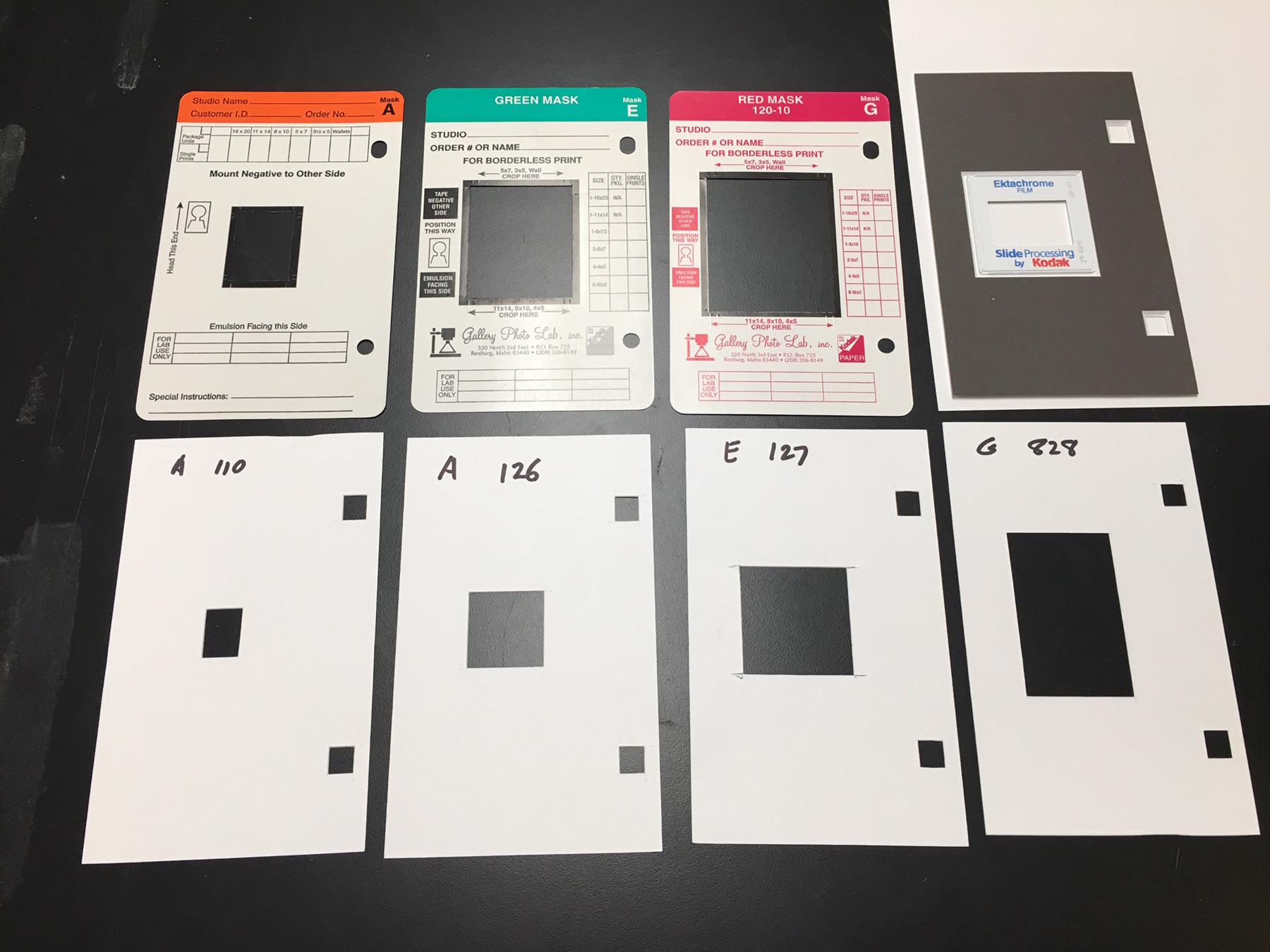

I am also looking for some Crop Cards / Aperture Cards. I have some A, F and G cards, but would love to get one each of B, C, D, E, BSQ, CSQ, DSQ & ESQ. I can cut additional ones on my computerized mat cutter, but it would help to have one of each to use as a template.

I can send you a USED card C, D, and E. I can also scan into PDF the A, B, and F cards so you have a template. And the actual C/D/E card can help you to scale up/down the PDF illustration so you know precise dimensions.
I have one unused set: A, B, C, D, E, F, G, H, BB, CC, DD, EE
Jul 26, 2019
5
USA
DSLR
That would be great! Thank you. Are the BB, CC, DD & EE square? If so would you be able to scan those also? Ted Nichols, New Hope Photo, 358 W Bridge Street, New Hope, PA 18938.
My end game here is to create custom sized crop cards for 126, 127, and 828 negatives. This would be easier if I have a reference crop card for each size so I know exactly what area is being scanned with each size crop card and can choose the size closest to the negative size I want to scan. I also want to make a crop card that will allow me to scan a 2x2 mounted slide in 126 or 127 Super Slide format without cropping, as well as one for 120 mounted slides and stereo mounted slides. I am using a Noritsu HS-1800 scanner with the MFC carrier with the Crop Card carrier. This will be much more efficient than using a flatbed scanner to scan these odd films. I remember back in the day at the PMA shows when there were dozens of venders selling crop cards and samples were plentiful. I'd be happy to share the end results with you if you are using a crop cards for scanning. Thanks again.

I am using a Crop Card carrier on a Noritsu HS-1800 with the MFC carrier. I am trying to create custom sized crop cards for 126, 127 & 828 negatives as well as 2x2 mounted 126 and 127 Super Slides and 120 mounted transparencies, This will allow me to scan these odd films more efficiently than on a flatbed scanner.

Here is a photo of several crop cards (3 on top row) along with my first generation of ones I am making to scan older odd sized films that are not accommodated by scanners today. I have some tweaking and refining to do, but these are a big time saver compared to scanning these odd negatives on a flatbed scanner.
