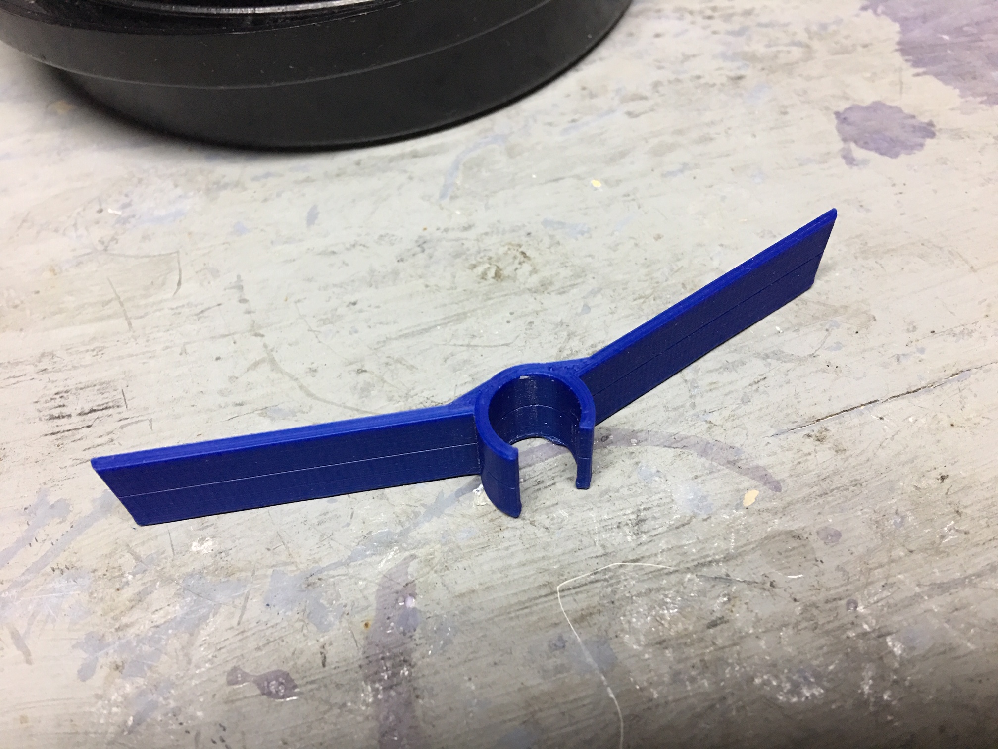

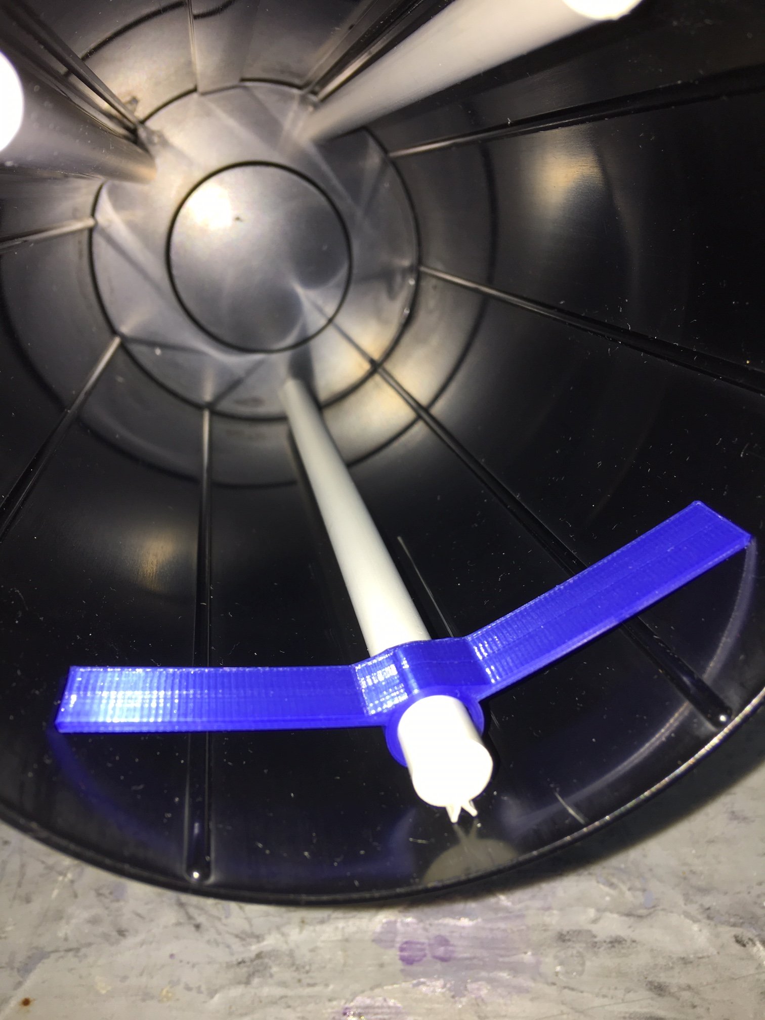

I purchased a Cromega Film Dev Tank many years ago. There is a Film clip inside that holds my 4x5 Film. These are easy to misplace or break. So I created my own and 3D printed it in PETG Plastic which is chemical proof. If you want one of your own...download my design. It is free. Share it with your friends.. Happy Processing...:heart:

Honestly, I had never designed ANYTHING before. Thingiverse is pretty easy. I got my micrometer/slide rule and just designed it in specific shapes..and then joined them together. It's not perfect but it works. Just go to youtube and watch some tutorials. In a couple days I was done. I printed it on a Creality Ender 3 Pro. Easy Peasy.

I've tried small clamps but the paper easily slide under, those big wings you have look really effective, thanks for sharing!

Here is the development of the piece in Tinkercad. Tinkercad is a basic design builder. It took me a couple of days to copy the design. I have since printed this piece and have used it twice with 4x5 development. it works great ! In the design using tinkercad you might notice one of the 2 "wings"..is undersized. It's not by much, but it's close to 2mm (each side). If you have your own 3D printer, you can print one of these for about ten cents (usd).
The first one I made the wings were too thin, so I pulled the drawing apart on my computer and fixed it and then rejoined it and printed it. Worked fine the 2nd time. I got lucky. lol.
I have never designed anything before. Tinkercad has you basically design separate parts and then you combine them together and make the object. I was looking for free open source software, as I use LinuxMint for an operating system. Tinkercad and Thingiverse are both free. There is open source software that could design it better but I didn't want to have to make designing a part so complex. Look up Tinkercad on youtube. There are tons of videos showing you how to build things. It's fun.
Enjoy the link. The other tank people are posting, if you don't have a part for a tank, make a cardboard piece and test fit it, then measure it and design your own or send me the measurements...so I can design another one. Honestly, a couple of nights and it's done.
