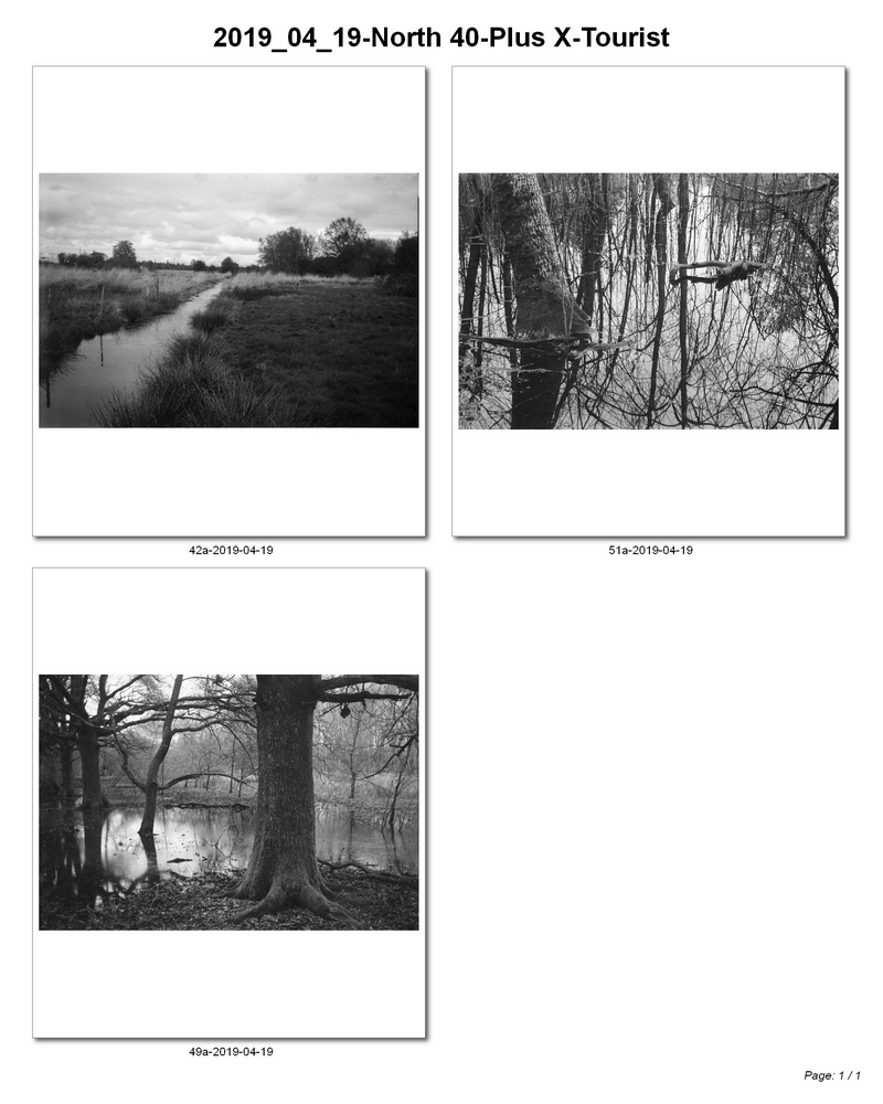

Here is an example from a partly damaged roll that I chose to include just 3 of the 8 negatives on:
The file names are inserted by the program - I identify files by the date and the negative number.
