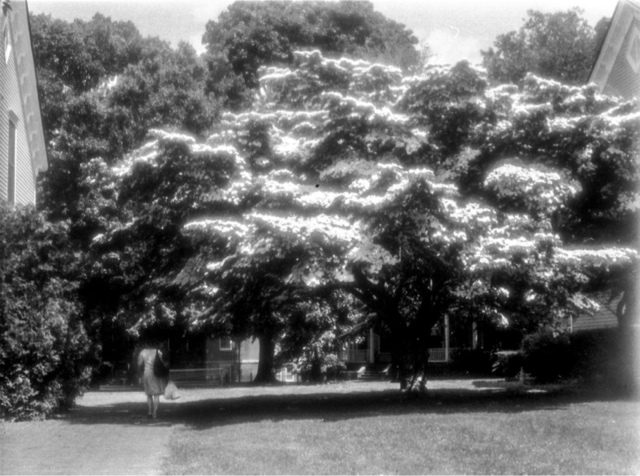

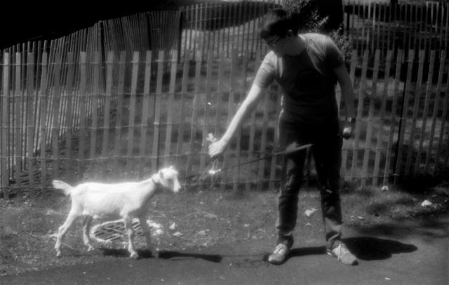

These shots were from a few years ago on panatomic x without a lens hood. (The images are low contrast but very sharp in prints, hard to make out on a screen but on an optical print you can make out fine details like clearly defined hair strands etc) You can see it becomes very pronounced when the lighting is contrasty (like the image of the tree) and it bleeds a bit into the darker areas.
