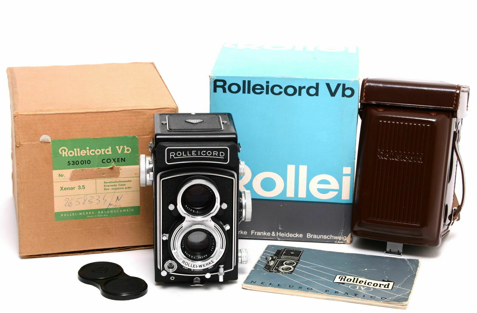

I have had a Rollei before and shot many rolls of film with one but...on the the Rolleicord VB that I just received the back door will simply not open, as in stuck closed. I release the latch at the bottom the camera and the back relaxes a little as in it will wiggle back and forth like it wants to open but simply will not fold outward to open. This is a "New Old Stock" camera that has never been used.The pictures in the auction site show it opened but it won't do it now. Could something slipped inside during shipping that has it jammed?
Any ideas?

Did you (1) turn the silver lever and (2) flip up the latch. Then use the flipped up latch to pull open the door?
That mechanism is quite simplistic. It is unlikely that something dislodged in shipping. It isn’t unusual for the door to be a bit “tight”.

Pull the bottom section away, up, from the body.. how to describe? Use standard orientation in use? So you want to pull the front clasp part of the door down, away from the body, towards the 'ground.' So, up/down, pull away from body a bit and then back?
The leading edge of the Rollei door is designed to slide over a ridge and grab a bit as you close it. To open, you usually don't notice this much as the door will simply slide back over the same ridge. Sounds as if your door's leading edge is very tight.
New old stock? What a crazy idea for a 50-60 year old item.

[QUOTE="Dan So, up/down, pull away from body a bit and then back?
New old stock? What a crazy idea for a 50-60 year old item.[/QUOTE
yeah!!!
Finally it opened. The “pull up then back” worked. I knew they can be tight but did not remember the little bit of a ridge and the need to pull up away from the body first and then back.
Thank you all for the help, ya’ll are just great and i just love this forum.
yes New old stock on a 50 year old camera is pretty wild. It looks it too. In box with case and instructions in German. I’m going to have to get a cla as it’s never been serviced and the shutter blades seem slow.
thank you all again
Robert

I have had cameras do this when some adhesive has gotten down in the grooves that the door edges fit into when it closes.
I would face the camera downward, drip some alcohol along the door edges and let it sit a while.
Some dope may have "replaced the light seals" which do not exist on any Rolleicord I've ever seen.

That's going to be a bit difficult as the latch is not designed to flip up on the Rolleicords. It is a straight single part- no hinged part to flip up as on the Rolleiflex latch. Well, maybe Brian meant to flip/pull/push the latch 'up' as in away from the body and up in the typical orientation for opening the back...
See page 6 of the user manual. That’s what I was describing.

Yes, i did read the instructions online twice. It made no mention of pulling upward before pulling back on the door. Plus this one is not broken in at all. I also did not want to break anything.

Ah, ok, I was wrong about it being a single part with no hinge. It is hinged and you do need to flip up the latch to clear. Should make giving a little upward tug easier with less chance of bending the latch.

s-l1600.jpg I will try the exercise routine. It would be nice to shoot a little before its cla trip.
I kind of figured before I bought it that it would need a service since its been unused for so long.
I can't believe I had so much trouble getting it open, although my Rollei shooting days were about 30+ years ago.

I wonder if the paint has changed shape. Those were the days of solvent-based paints. They can be gassing off for a long time. I bet Rollei expected that the back would be opened in a relatively short time after they close it, box it up, and send it off to be sold. Maybe sitting closed for so long so soon after manufacturing led the paint to melt a bit, expand strangely or some other defects to grow as the last of the solvents hung around. Or other solvents from the packaging seeped in.
Examine the back/body interference area. Look for any change in the paint surface. Rub it down with some safe cleaners- alcohol, maybe a little Windex? See if you can 'polish' the paint in the area a bit? Start in the middle and do testing before using something that could affect the exterior paint!
I've never had the experience of dealing with a new in-box Rollei TLR. Maybe this kind of minor binding was designed in, and it will relax after a few uses. I've seen a fair amount of variance in the 'clip' action of the back, from almost no friction to binding. I know people who have forgotten to close the latching mechanism on a Rolleiflex, shot a roll, and had no light leaks! The clip action is not an accident. You might find a particular angle for pulling that leads to quick opening.
As shutterfinger says, the back is relatively weak and prone to bending. It is possible to increase or decrease the interference, and I fine tune backs all the time. But I wouldn't suggest you attempt this in any fashion in this case, at least not before a few months of use! I would hope that Rollei knew how to package their cameras to avoid damage in transit and stocking, but again I doubt they were expecting the camera to sit for 50+ years in the packaging!
