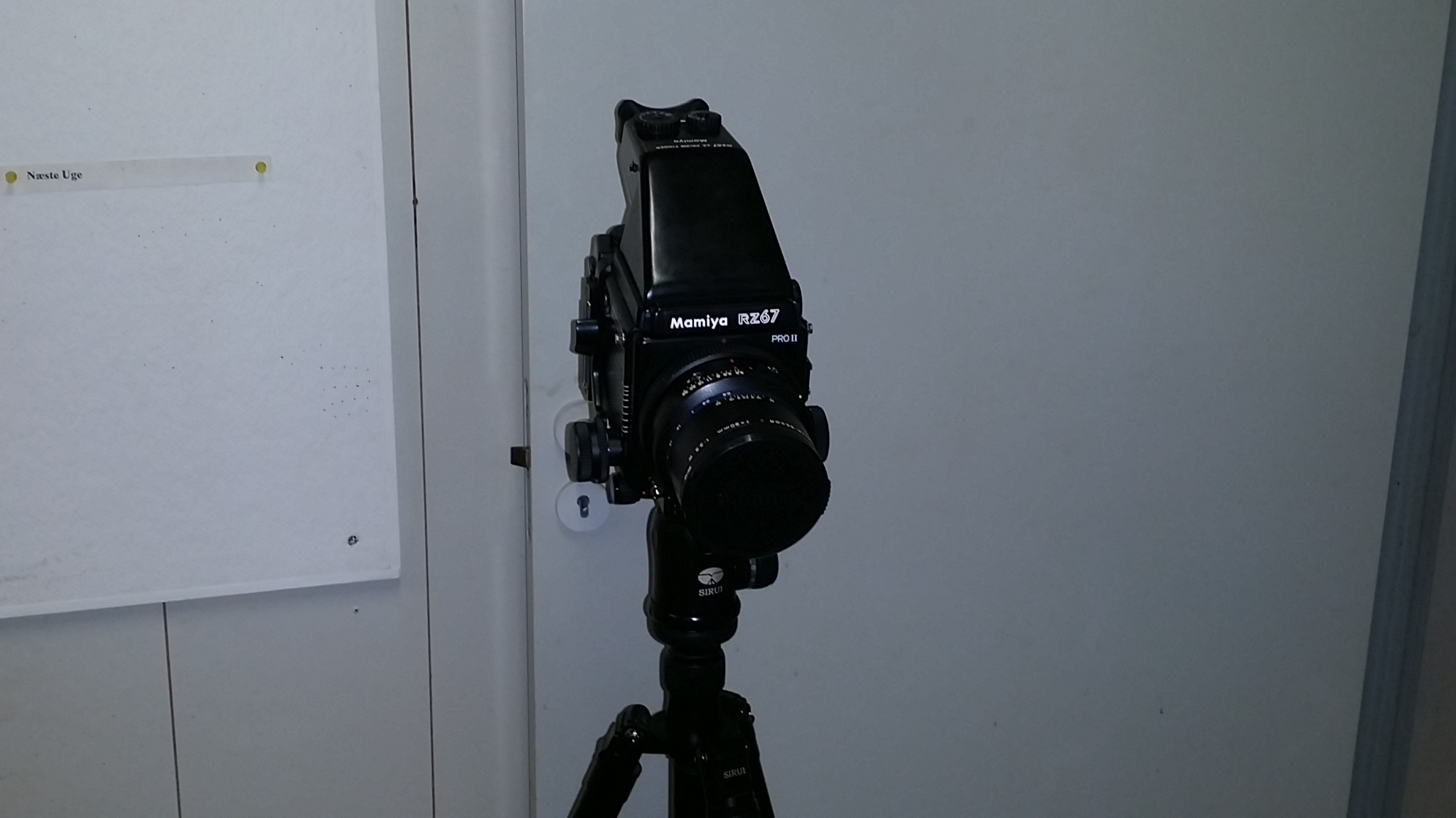

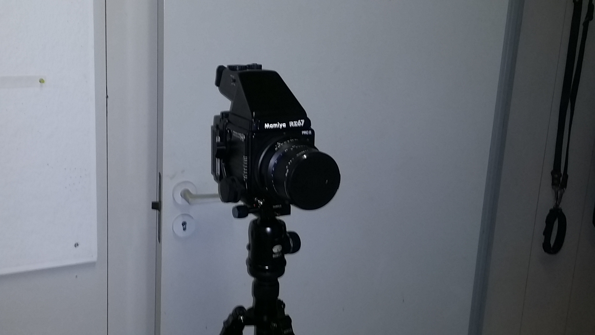

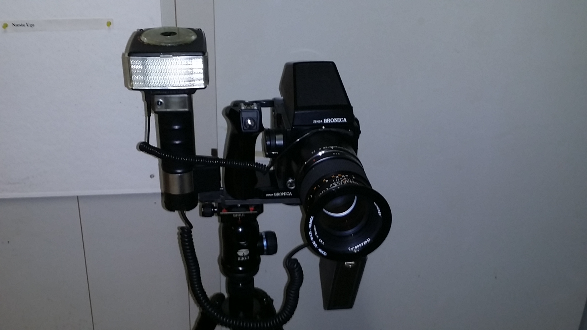

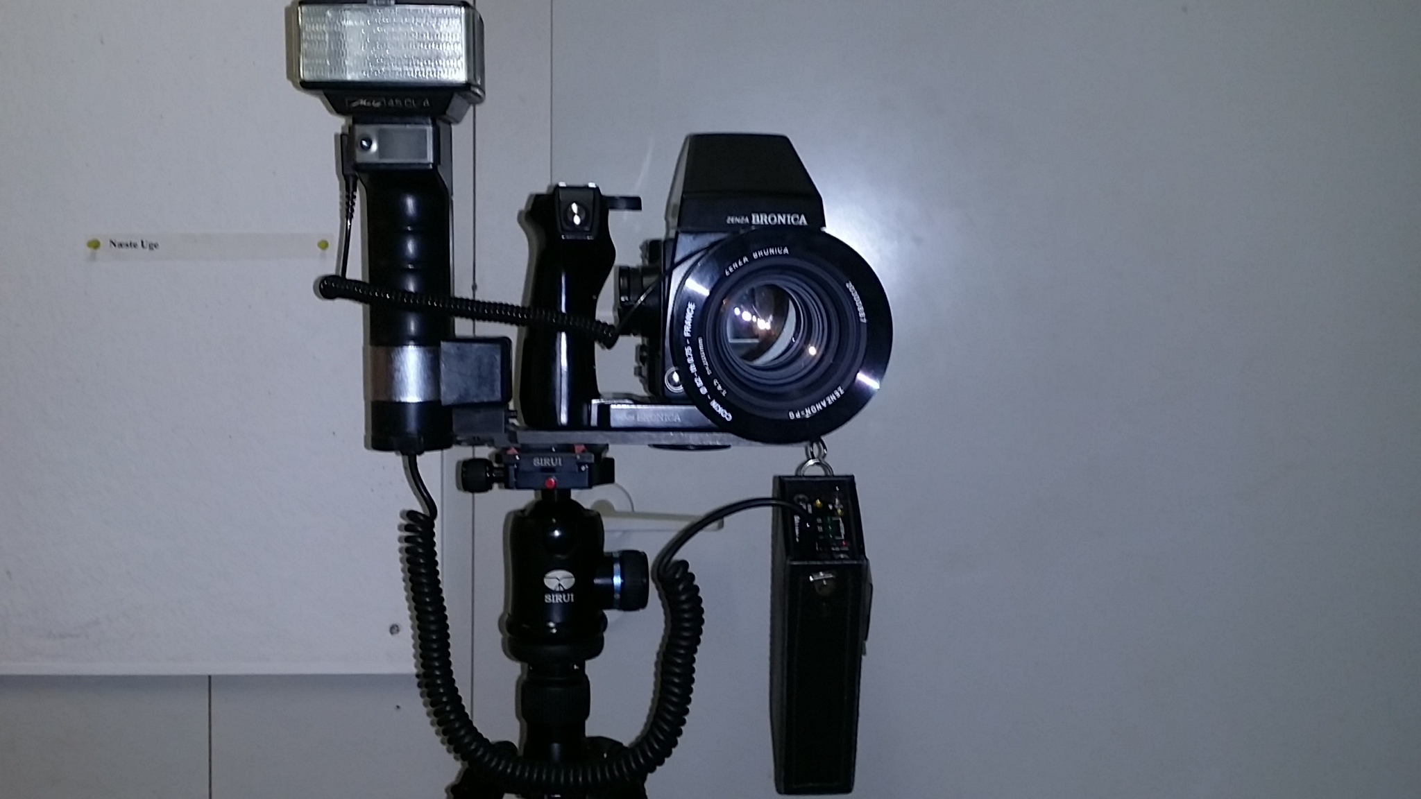

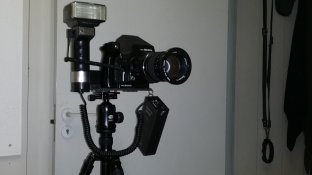

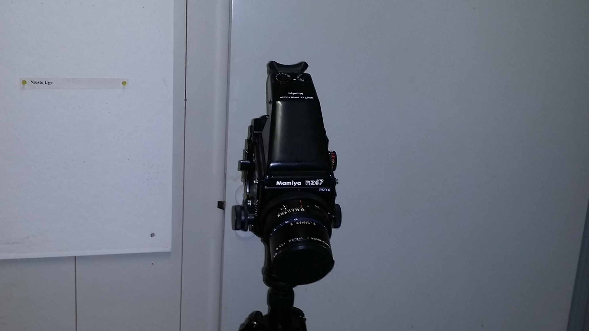

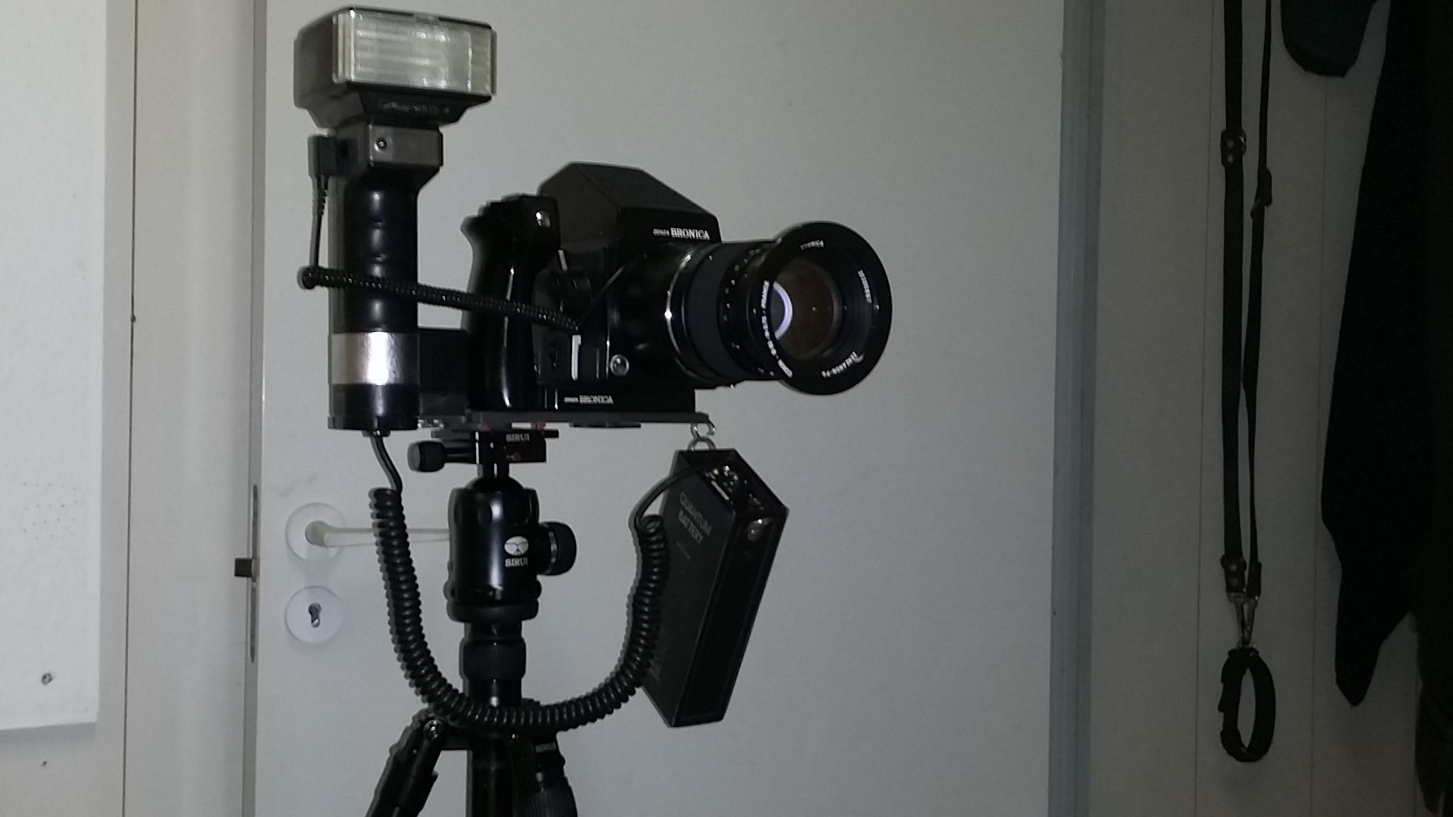

MattKing I really don't see the need to adjust the tension control, which means that I have to loosen it even more, when I go from GS1 to RZ67, that weighs only half. I'll attach some pictures to show what I mean, and they have been taken with ~ 30 sec. interval.
attachment.php
attachment.php
attachment.php
This is my Bronica GS1 with 2x extender, 200mm lens, flash and battery. As you can see, it is very off axis weight vice, and it stay how I put it.
attachment.php
attachment.php
attachment.php
Here you have the problem, RZ67 with 90mm lens and quick release plate centred in the balance point.
I only took off the GS1 and mounted the RZ67, did not change anything on the tripod.

It is not the weight. It is the torque.
Okay MattKing, torque in my line of work as a scaffolder is like this:
You have a rod, mount it in one end to something and in the other end you mount something heavy. the force you need to hold that weight up, is torque.
If you look at the pictures of the GS1, you will see the combined mass of the camera and battery is roughly 7" from center of quick release plate, and the mass is roughly 17 pound which gives a torque of ~29 foot pound, then we can argue that the flash makes a counter torque, which is right, that amounts to roughly 6 foot pound, but summa sumarum you have a torque of ~23 foot pound trying to tear the camera/battery down that way.
If you then look at the picture of the tilting RZ67, the quick release plate is within +- 0.2" from centerline, both front/back and side/side. My guess is that the torque we are talking of here is below 1 foot pound.
As I stated, I only opened the plate release, took off the GS1, mounted the RZ67, tightened the plate release, and didn't touch anything else on the tripod.
Now why does the tripod/ball head combo behave as pictures show ???? I have for the world not the faintest clue, and that is why I ask here.
MattKing
Apr 24, 2005
53,223
Delta, BC Canada
I expect that the centerline of the camera and the tripod socket are both significantly displaced from where the centre of gravity is.
