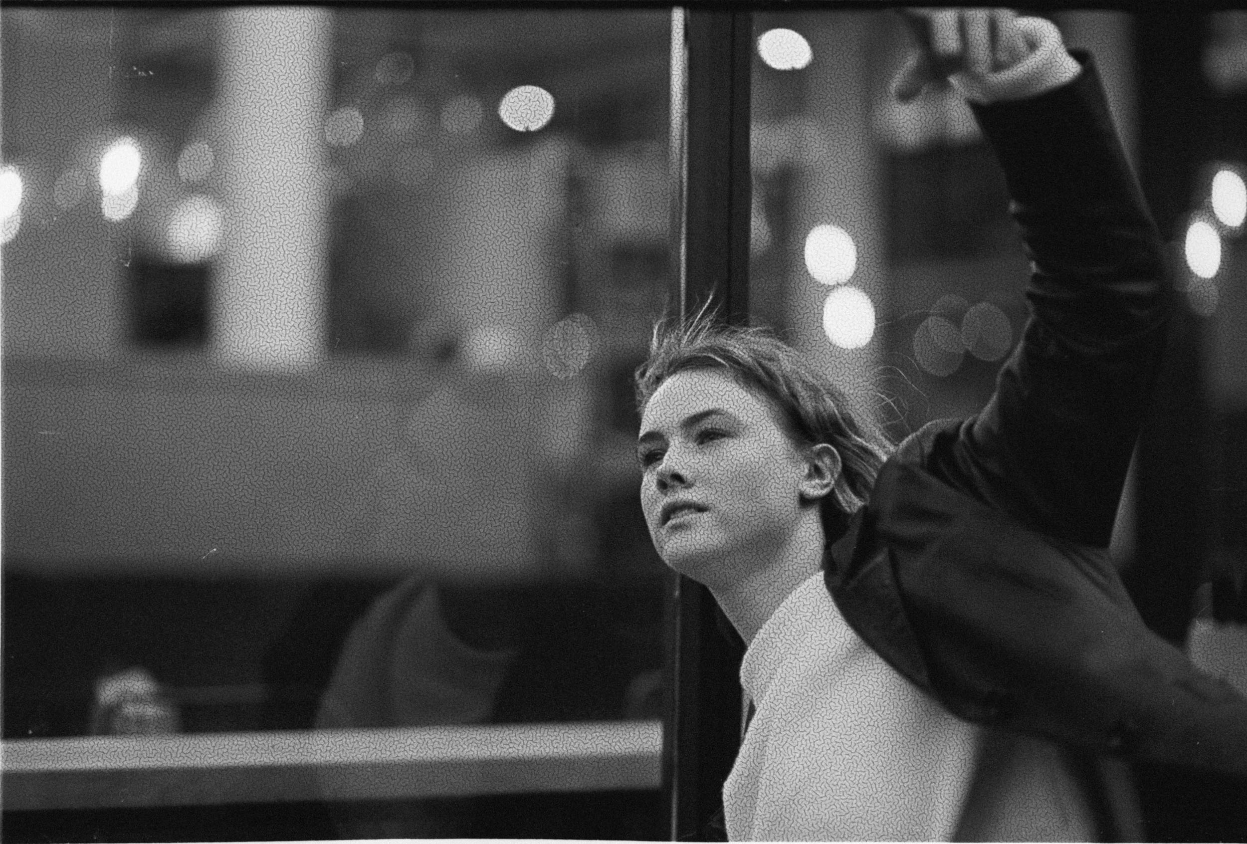

Evening,
Hoping someone has seen this before and can give me some idea what's happened. Just developed 4 rolls of 35mm Tri-X in my Paterson tank and all four have the same weird crazing pattern. I am stumped by this I've thrown 40 odd rolls of film through the same combination of camera, film, chemicals and development method with great results until now. Very simple setup - D-76 (1:1), Kodak Indicator Stop, Ilford Rapid Fix. All times according to the datasheet.
The only difference with previous sessions was that I used a brand new bottle of Kodak Indicator Stop - but surely it can't be this? Having done a test with a known good negative I also know it ain't the scanner.
Baffled. Anyone got any ideas?
Reticulation. Didi you use really hot water sometime during processing or washing?
Hot no, but I did use some warm water from a bath for the final wash out of lazyness.
Bet that was it. Bollocks!
Reticulation, but you may find that it is particularly emphasized if you are scanning.
And I've learned a valuable, if expensive, lesson.

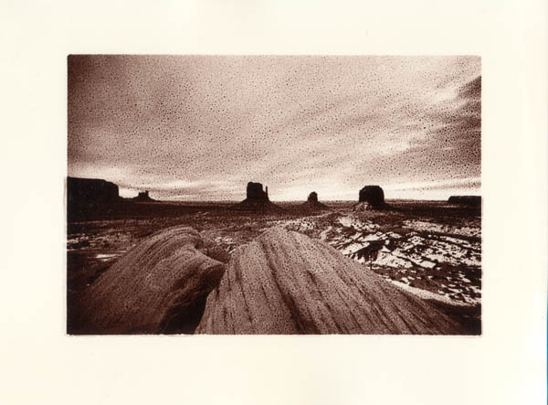

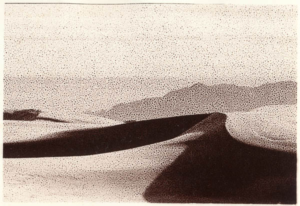

This happened almost 20 years ago. I was washing some film and went to meet a friend for dinner. Left the film soaking figuring I'd be back in an hour or so. Dinner turned onto a bar and, well, don't think I remembered the film until the next day. That is the full negative. I ended up printing them anyway. Really small. They are bizarrely beautiful prints.
Holy crap that looks awesome. So you just left the film in soak for next day after fixing? I must try that!

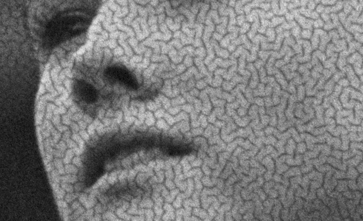

Evening,
View attachment 289553 View attachment 289554
neat trick!
Josh T I hope you can do this some more when you want this kind of look. for years I've done everything to screw up my film as much as possible to get wonderful serendipitous effects like this. I hope you don't think I am joking, this is wonderful stuff, she looks like a cast member from a sci fi movie! :smile:
Patrick I hope you made more of these mistakes, they would make a beautiful pages in a small hand crafted book.

I did it again just this last week. Developed some film at night and forgot I left it soaking until the next day. This time the negs were perfect. Eastman XX and Fomapan 400. I think Agfa APX 400 was easy to reticulate. It would just depend on the film.
@Patric Robert James are you sure you didn't use too hot water on that case? Can you provide the look of the reticulation up close on these?
