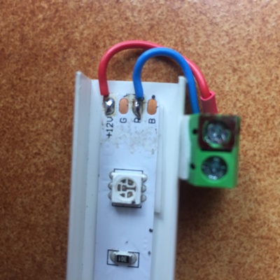

Some time ago a coworker gave me a RGB LED strip salvaged from the dumpster. I saw an opportunity to improve the safe lighting of my darkroom, two 15W red tungsten bulbs, overall quite dim, just enough to find one's way around.

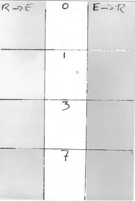

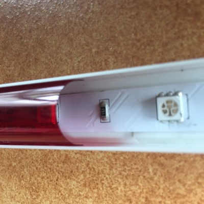

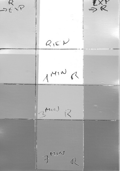

I thought RGB opened the possibility of a combined safelight/whitelight in one fixture. But the DC/DVD test showed that the "Red" also emitted some green light. So I ordered a piece of Lee Primary Red 106 sheet filter, and proceeded to integrate the strip in a U-shaped PVC profile for mechanical support. And out of curiosity proceeded to do the Kodak safelight test without the red filter.

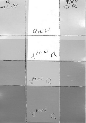

Next I added the red filter, using the natural curvature that it had acquired during storage and shipping. The slight inward slope of the walls of the U profile also helps keep the filter in place without glue.

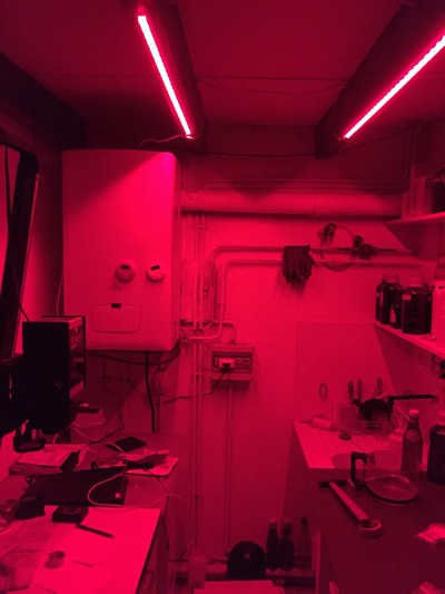

Now it's (almost) daylight.
Final note. One needs also to test the red filter that swings under the enlarger lens. The paper receives some exposure from that if one adjusts the placement of the paper before the exposure.
