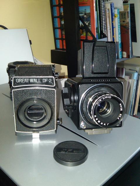

Okay, after playing with and being totally smitten with the Great Wall DF-2 camera I have. I realized that the body will likely only have a short life if I continue to use it like I am. However, the lens has this wonderful signature that is just too good to waste. So I got creative and thought about how I could adapt this asian wonder to more thoroughbred camera marques.... Well, after about an hour of tinkering in the garage today, I came up with this..... Crappelblad, Frankenblad, Greatblad, Wallblad, not sure on the name yet.
I used a spare body cap milled out to accept the thread of this screw mount lens. Voila, inifinity focus, close focus using the focusing barrel. Easy peasy lemon squeezy. Now I just need a 201f body with focal plane shutter!
One other thought about the vignetting the Great Wall camera has is due to there being metal parts and felt actually in the image plane. You can see it at the bottom of the lens opening on the DF-2 (flat ledge) I can imitate that with some felt on the body cap and the job will then be totally complete!!

Congratulations!
But maybe the job isn't totally complete until you adapt the Great Wall to take Zeiss/Hasselblad lenses?

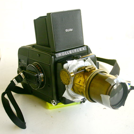

well - Hasselblad has a good name for this.. (I'm on the same path; trying to make a "Dianablad" with an old Diana lens fitted..
However, I prefer my Rolleiflex for this sort of things.. due to the shutter in the camera, and the bellows.
It works quite good and is FUN to try..
Only problem is the name..
I've made an Rolllancaster if you will...
My Rollei with an old Lancaster landscape lens in front.. It works.

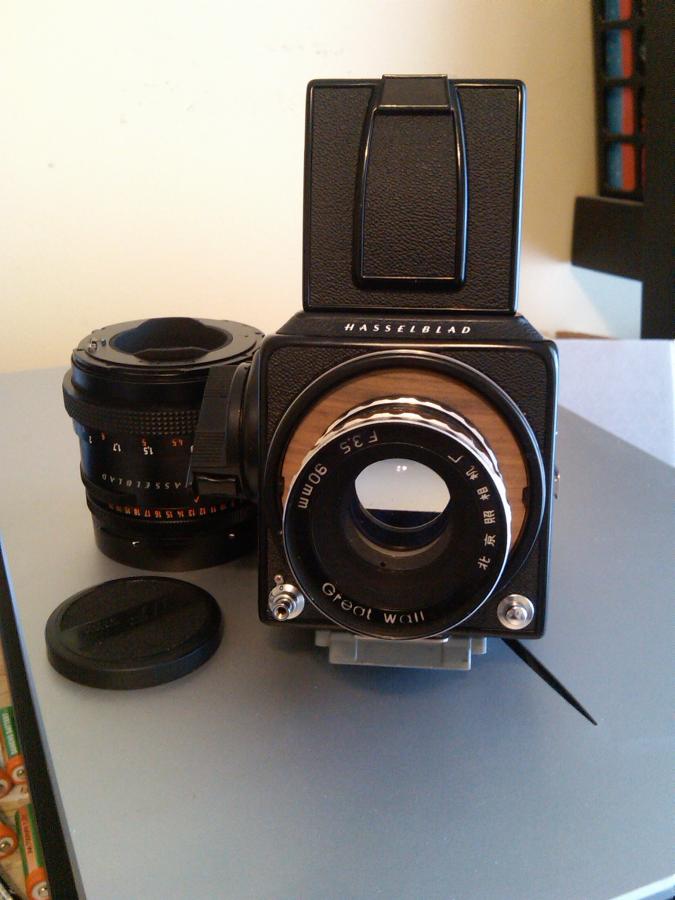

Okay, as an update..... The Great Hassle just got an extension tube :smile: Using the modified body cap as a template, I was able to mill a rosewood disc that fits inside the body cap and has a hole in the middle for the lens to fit into. The extension disc is just a tad over 1/4" thick and allows close focusing to move from 1 meter to around .6 meter. I will likely make a double thickness version of this to give me even greater flexibility. The Planar is in complete disgust at such absurdity!

Looks like so much fun! When do we get to see what this amazing combo can produce?
(BTW - I want one for my Hasselblad!)

I have to acquire a 201f first, then all will be revealed.... However, seeing the image on the acute-matte on the 500 c/m, it looks great. Not as much fall off as I'd imagined and I attribute that to the blad having too flat a film plane. I think the way the great wall film transport worked allowed some film bowing that contributed to the overall 'look' and vignetting of the image,area. That said, the out of focus areas are wonderful to look at. I am itching to try the new rig out, but I have to be patient and wait for the focal plane body.
