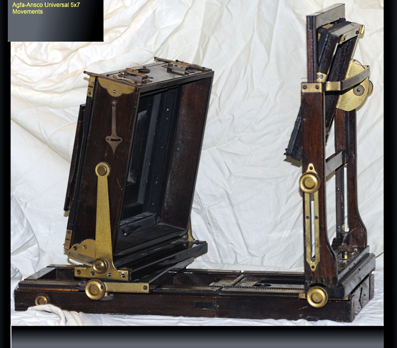

My new fix-it project is an agfa-ansco universal 5x7 whose bellows has long since rotted away, leaving only the end frames and shreds of fabric clinging like tattered sails on a ghost ship :smile: For those of you who like dating these things, the salient features are cherry and brass with front standard rise & tilt (but no rotate on the vertical axis) and rear tilt, the tripod mount appears fixed in place; I think that puts it at 1940-41?
I'm taking the opportunity to learn and fabricate my own bellows but find a lot of contradictory articles, and mostly for folders on cameras 4x5 and smaller. I've seen everything from neoprene to bookbinding cloth and almost all require existing stiffeners, which is something that I will have to recreate.
Can anyone recommend resources for this project that would match how period bellows were made, materials and techniques and plans I can modify for my purpose?

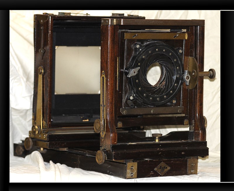

Thanks for all the suggestions and pointers, y'all are helping to make this a fun project! Fortunately for my future stiffener drawingsI have one rib from the back and one from the front of the rotted bellows to sanity-check what I come up with. And the wood panels, of course.
For reference, this is the beast:

You're lucky as you have one of the better Agfa Ansco 7x5 cameras with the front tilt, it's quite frustrating when there's insufficient tilt like on my 10x8 Universal.
The original Agfa bellows are actually quite thick and bulky and it will be easy to make a replacement. I need to make 5 or 6 sets as soon as I've moved in and settled in my new house,
