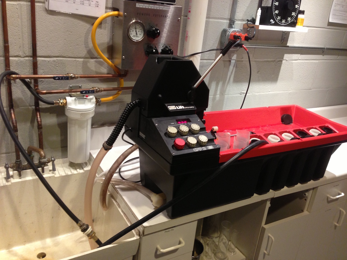

I put the fill hose in and let it run until I hear water coming out the overflow drain. I fill with 24C water and mix the chemistry with 24C water; the unit is ready to go almost immediately.
