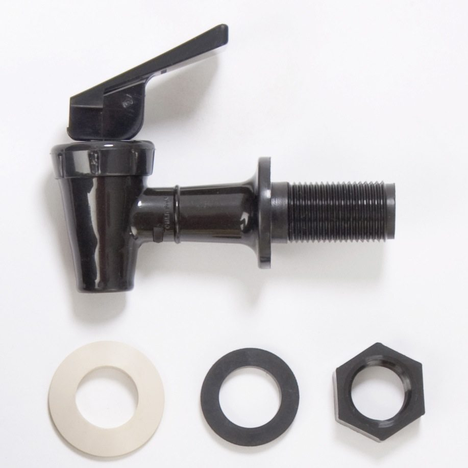

That's how I empty mine. I have considered drilling in a spigot, though, like this:
