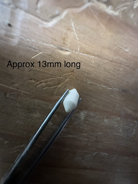

Hello all,
I have the CPE-2 film processor and was having problems with temperature control. So, like I knew what I was doing! Which I obviously didn’t I opened up the control box and found that a tiny plastic pin was used to balance the thermostat control, and it had shifted sideways. With a pair of tweezers I tried to straighten it and dislodged it altogether. In trying to pick it up again, it flew from the tweezers to the nether regions of my darkroom never to be found or seen again.
Bottom Line, does anybody know where I can find to buy such a minute but essential part of a piece of such expensive equipment? I have provided a photograph of the little critter if anyone is interested or can help me. IMG_1979.jpeg
