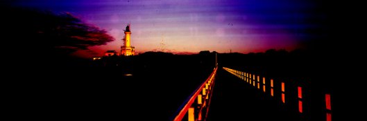

Have a problem with the counter numbers appearing on an image, is it possible that an old roll of film will transfer the dye to the film base or do I have a light leak in my camera?. Old film with Provia100-1999. Colours are fine in actual image, but have saturated the attached image to show the problem
Cheers
Shane

Seem like I might have to buy a stronger torch to look for the leak. But it would have to be fairly significant to imprint the way it has. Do you know if older backing paper was thinner than the newer stuff because it does appear on a Tmax test roll I did.

How do you wind your film? With a red window or similar to look at frame numbers? I agree that it's light coming through something like that and exposing the film through the backing paper. There are also big horizontal streaks that I suspect come from a similar source.

There is a sliding cover which reviles a hole to show the frame number, but it is in the top 1/3 of the frame ( iwind left to right using the 6x9 frame numbers), these number imprinted are in the sky so in reality are the bottom 1/3 when the image is reversed in camera so I don't think its the counter hole because light through the counter hole would show up in the lower section.

Loose roll? Changing rolls in full sunlight?

Ink transfer

I think that's more likely than it being printed through by light as the numbers and marks on your image are lighter than rest of the image. If light was passing through the paper to the emulsion, the numbers and marks would be darker.

I recall, on a visit to the Ilford/Harman factory, the manager at the roll film line mentioning that special printing ink has to be used on the backing-paper to avoid print-through onto the emulsion. (The printing is, of course, in direct contact with the emulsion surface for the whole time the film is rolled on the spool.) I've seen this print-through myself on a very old B&W film.
If there is no obvious light-leak issue, I'd try the camera with a fresh film.

This is what happened when I had a loose roll in my pinhole camera: apart from the expected fogging at the edges, there's also an image of the numbers on the backing paper, although I can't explain how. (Ilford FP4+, so near-black on off-white printing on the paper, and decent quality normally light-tight paper).

I would try a roll of fresh film. It's probably more likely from fogging than ink transfer, but it should take quite a lot of light to accomplish that.
I've changed plenty of rolls in full light and never had a fogging problem. The symptoms make me wonder if the the backing paper my have faded causing the problem.
