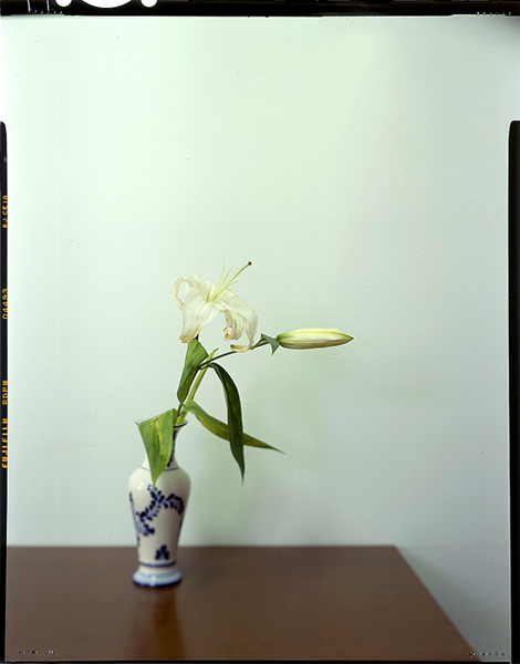

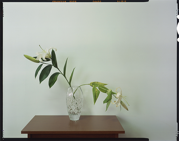

I followed the instructions to tilt the front and back of the camera, try to get everything in focus. The picture I got is worse than the one without tilt, they were all shot at same F stop. I just can't figure out why.
The set up is 150mm lens on 4X5 camera, subject about 1.5 meter away from the camera. camera is a little higher than the subject. I am really puzzled, isn't the tilting suppose to give a wide plane of focus?
Please let me know what I did wrong, thanks. Alex
the landscape picture is w/o tilt, the other one with tilt.

I see two still lifes. I don't see a landscape photo.
The set up for the camera should have the back perpendicular to the vase and flower.
If you have insufficient front fall then the camera bed should be tilted downward and the back returned to perpendicular to the vase and flower. The front should be parallel to the back unless you want additional depth of field in which case the lens standard should be tilted.
If you tilt the back you will induce distortion. Sometimes that is desireable. In this case, I would wonder about inducing distortion.
If you are shooting with the camera positioned directly in front of the vase and flower there is no need for swings or shifts. Those would only be used if your camera was to the side of the main object in the exposure or if you had more objects to the side of the main object in the scene and not on the same plane as the vase and flower and required more depth of field.
Beyond that you should be focusing on the ground glass with a loupe. If the image is sharp on the ground glass then the exposure should be sharp.
One additional thing. You failed to mention the Fstop at which the exposure was taken. If you stopped the lens down beyond F 32 on 4X5 you will probably experience defraction if you print this at much of an enlargement

Tilting the camera doesn't increase the depth of field - it changes the plane of focus which under certain circumstances can help encompass those features in a picture which you would like to have in sharp(ish) focus. This is most useful with things such as a flat landscape where you can modify the focal plane to closely parallel the landscape (rather than being normal to it) and hence keep most of the landscape in focus. The further away the object from the intersection line of the three planes (film, lens, focal), the greater the depth of field given the distance to the focal plane.
In the case of your flower and vase most people would not use tilts unless they wanted the flower to be in focus and the bottom of the vase out of focus. Rather than having me rehash things which others have already written do a google search for Scheimpflug.

You have the right idea, but in this case you really didn't need any tilts. If you want to learn about using tilts, you would be better served taking the camera out to shoot a landscape, then you can practice with the tilts. In the portrait version of the image, it looks like you really used too much tilt.

Thanks all for the help. I am confused with the DOF and plane of focus. But, on the slide the back of the table is not very sharp in the landscape version, isn't F22 should've produce enough DOF to cover that?
In the portrait version, I did find where the plane of focus is, it's between the letter RDPIII and a group of numbers on top of RDPIII.
