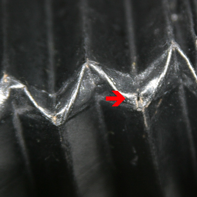

Dave I havent put a flashlight inside but I can clearly see light coming in when I focus at 2.5 feet, take off the lens and look inside. Heres a snap of one of the small holes.

Dave Parker
Aug 14, 2004
4,031
Hi Fintan,
Those types of hole are actually pretty simple to repair, I use what we call gaffers tape here in America, it is a non-residue tape that works very well for this type of repair I have done it on several graflex cameras and have been shooting them for years with no problems at all and the tape I use is black, so it blends very well with the bellows, that would at least get you going until you can get the camera in to have new bellows made for it. By the way, gaffers tape works great for redoing the hinge tape on film holders.

Fintan-I found some very cool stuff at a diving shop here in the states. I'm sure you can find it. It's called Aquaseal-a urethane adhesive and sealant. Reason I like this so much is that after it dries it is flexible as in bellows-flexibel. You must wait until it is dry and that might take several days. But it works very well....

Hi Dave, thanks for the post.
I think I'll have to have a go at that, my seller thinks it got damaged in transit, which I'd say is quite unlikely but the implication probably is it's not his problem.

Fintan,
I would have a very difficult time saying that is transit damage....but it looks to be normal wear and tear for an older camera, the weak spots in bellows are of course the folds, if you got a good price on the camera and it works for what you want to do, I would probably look into new bellows or put some gaffers tape over the pinholes and get on with shooting.
