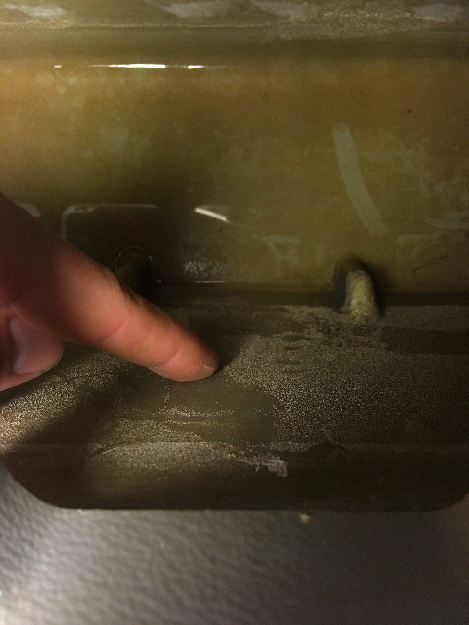

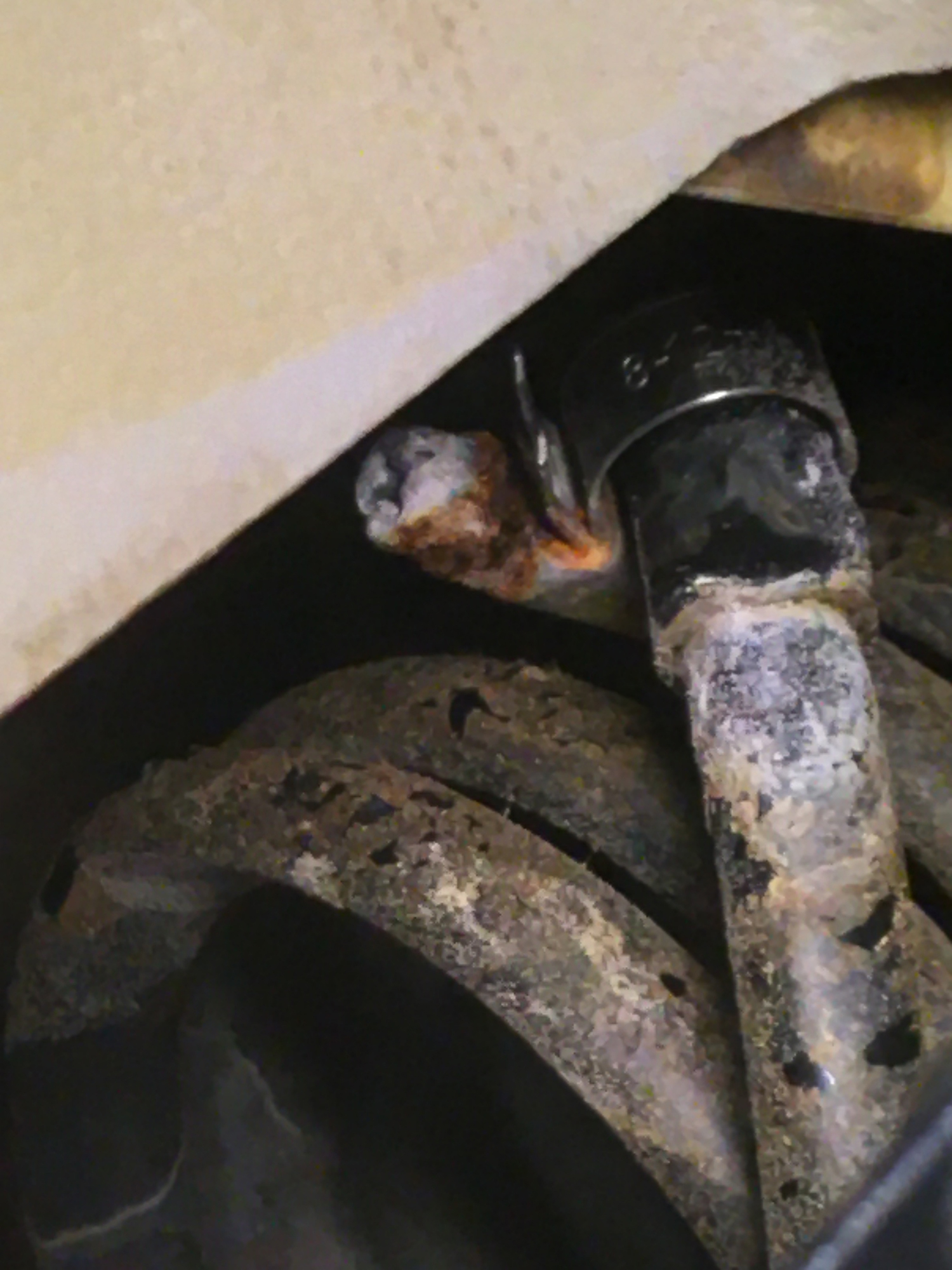

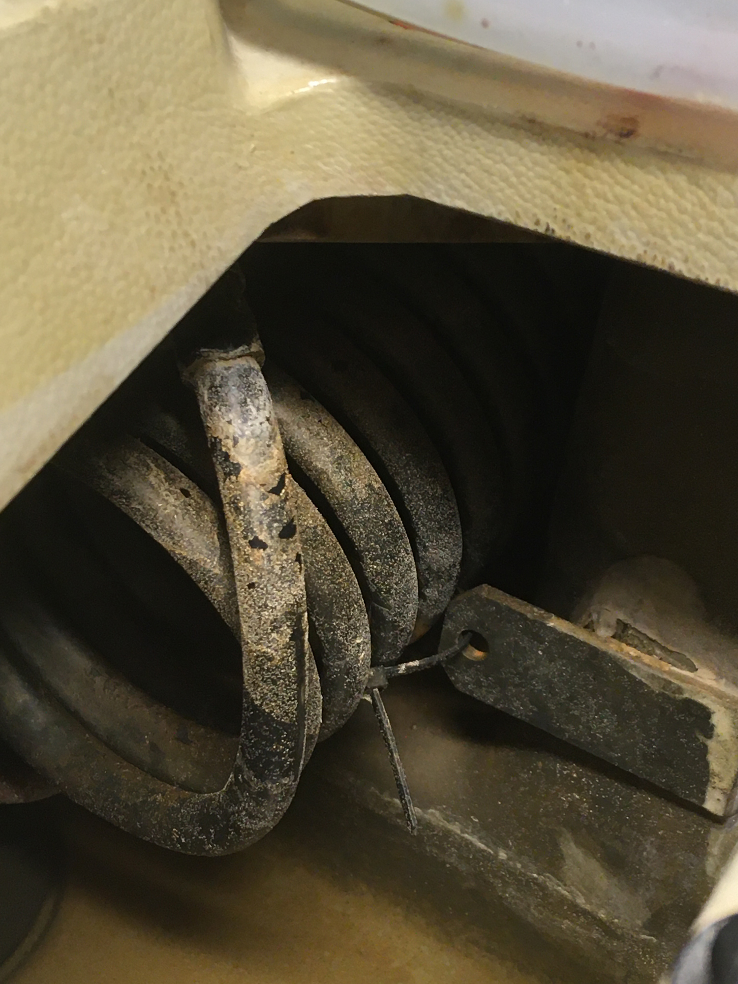

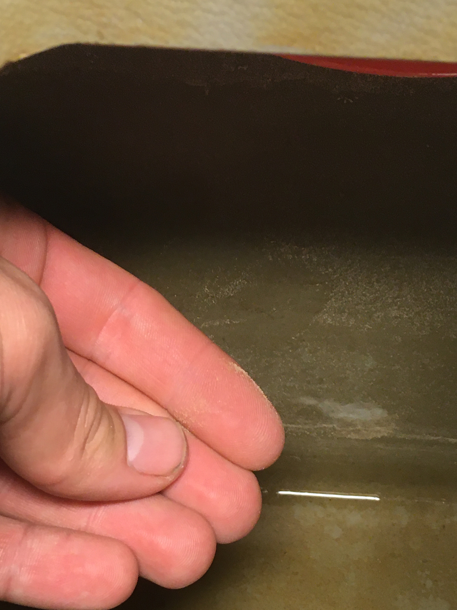

Hello everyone
Im getting very strange powder like residue after I drain my water jacket in ATL. It is corrosive to metals and eats my hoses.
I dont know from what that might be, maybe leaking chems into water jacket ? But seems unlikely, and even if, the quantities must have been high for me to notice.
Any idea how to ged rid of it ? or maybe prevent ?
Thanks a looot
David
That sounds really odd.
Could you post a picture of what it looks like?
Frankly, the only residue I'd expect on an ATL filled with (presumably) tap water is calcium scale. This is fairly harmless, but it can settle on hoses and other parts, making it seem like they're affected, while in reality it's just a thin layer of calcium scale that can be scraped off, or dissolved with something like acetic, citric or sulfamic acid.

Yeah, that looks like scale.
If you have any cleaning vinegar or citric acid, just fill your ATL's water bath, throw in a couple of spoonfuls of citric acid or a cup of cleaning vinegar and let the ATL heat up. Keep it warm for a couple of hours, then drain it and rinse it with tap water. Most if the scale should be gone at that point.
