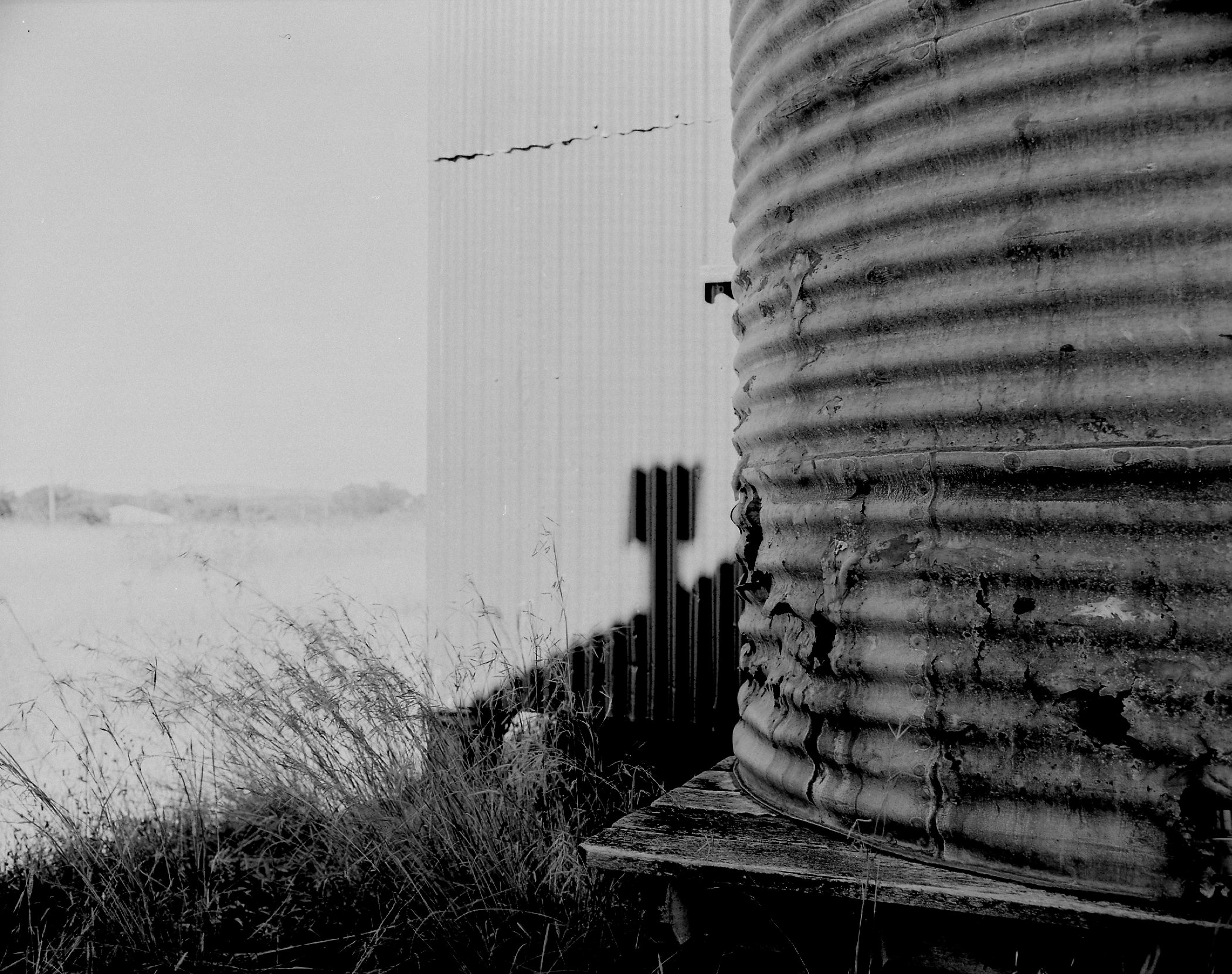

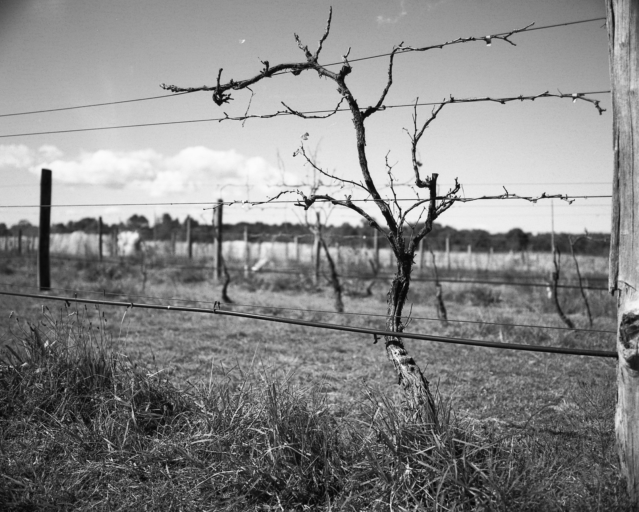

Ive only used it ilfosal 3 with Rollie 25 once. It was 5 minutes at1:9.
Rollie 25 is very contrasty film and builds up density in the high lights very quickly.
Depends on what you are photographing, here is a few examples, notice in a high contrast scene on the second there is too much density in the highlights. You really have to be careful with ilfosal 3 not to over develop the highlights.

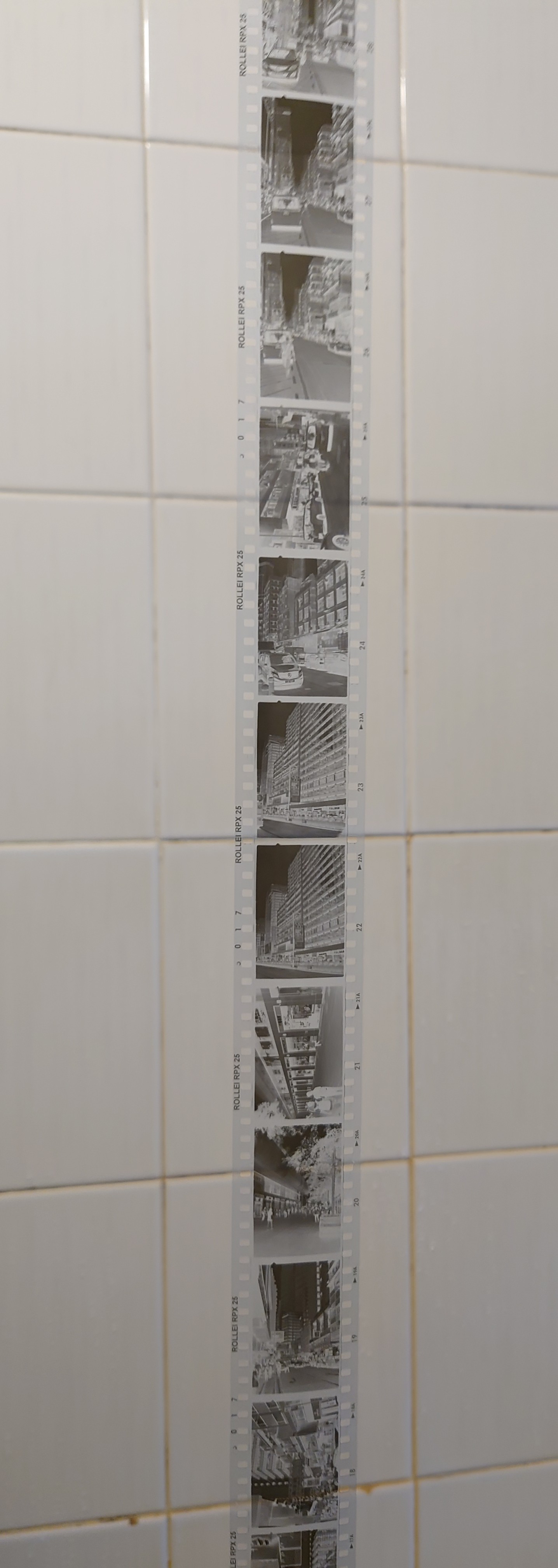

Update : it worked and worked well ! 😍
Ilfosol 3 in 1+14 at 23C for 4:30. 5 inversions at each minutes.
Ilfostop for 10s
Rapid Fixer for 4:30,
Washed with water and dishwashing detergent at the end and raised with tap water
The base slightly pale bule. But overall is clear.
Photos taken by Konica Auto S1.6
