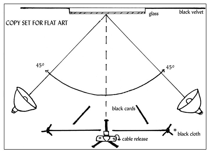

You shouldn't need any polarizing filters when copying. If your setup is correct then you won't get reflections.
Here is the standard setup for copying. (this setup shown is for horizontal copy, but the principle is the same for copy stand)
The black card would only be used if there was light overspill from one of the lights.
The black cloth would only be used if the subject being copied was highly reflective, like a glass framed print.

Thanks for all the great replies. I went cheap, and picked up a coupe folding-arm desk lamps from the big-box store this morning. Like the intro to PIXAR movie type lights. This evening I'll try the 45º angle set-up @foc posted, and see how they come out.

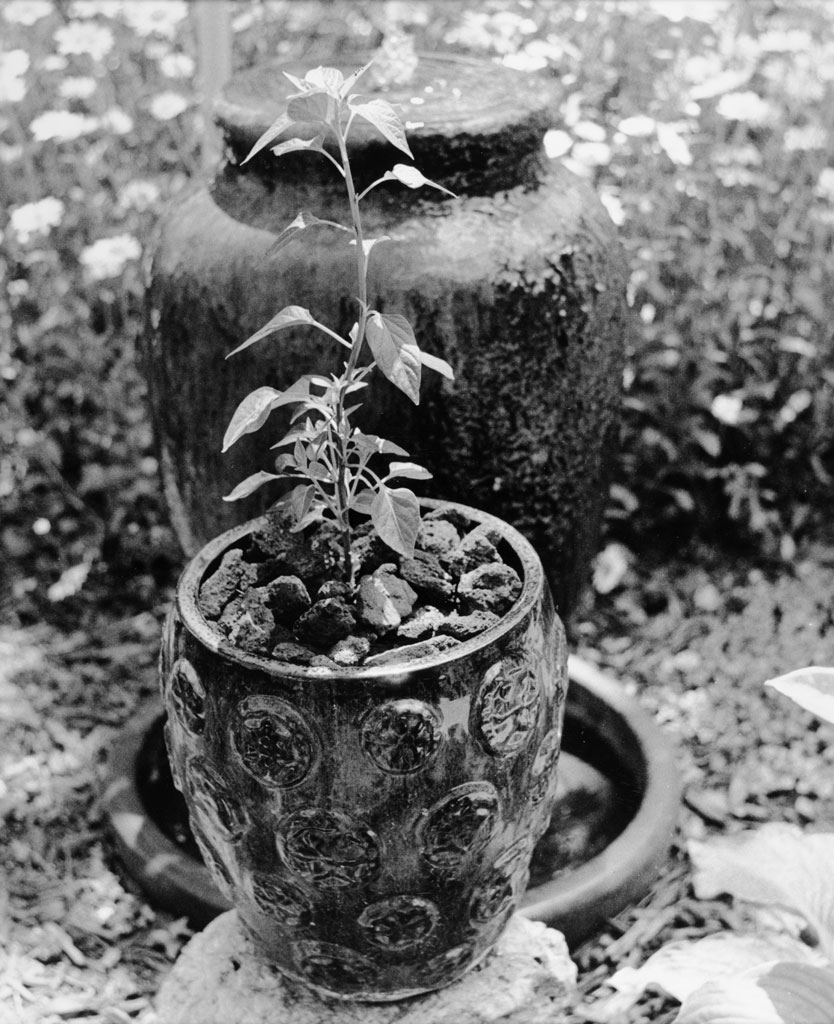

First try, with some practice, I'll get this working. This is an 8x10 glossy print.
Pieter12
Aug 20, 2017
7,525
Magrathean's computer
Super8
I'm not familiar with the original, but it looks good here. A couple of tips for to check the evenness of your lighting set-up: 1. Hold a pencil vertically, tip touching the copy board surface, and look at the shadows on either side. They should be the same length and same shade. 2. If you have a large grey card, about the size of the materials you intend to copy, shoot a frame of that and make sure there are no hot spots.
