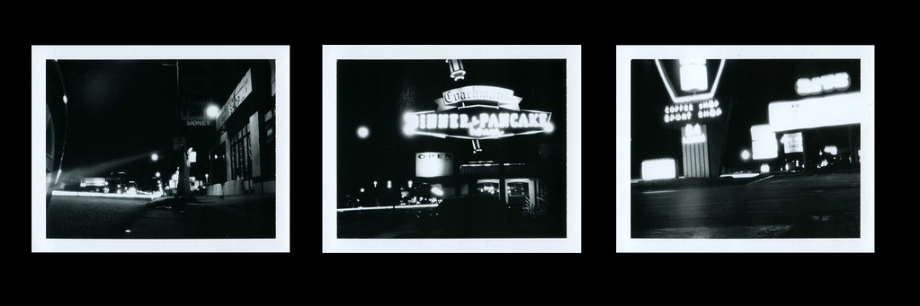

Night pinhole can be done!
Taken with Fuji 3000b Instant film with a medical Polaroid camera modified with a Prontor shutter and 5mm pinhole. Exposure time about 7 minutes.
I'm sure you made a typo on the 5mm pinhole. Just so someone else doesn't understand and make one that big - do you mean 0.5mm?
