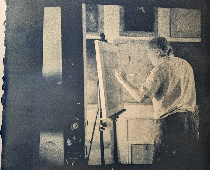

I gave it a go, and yes, you do get a blackish tone but... man, does that toner STINK! Even cutting the recipe in half and working with 500ml total working solution was brutal! If you try this way of toning, be sure to work in a well ventilated space. I had my vent fan running, as well as donning a respirator. Without these precautions, the fumes are overwhelming! Print was agitated in the toner for about a minute, then rinsed and washed.
O'neill, I wish I had your knack for being at the right place and time to snag a good picture.
Thanks, but this one was a planned/set up one of my friend in his studio. 🙂
