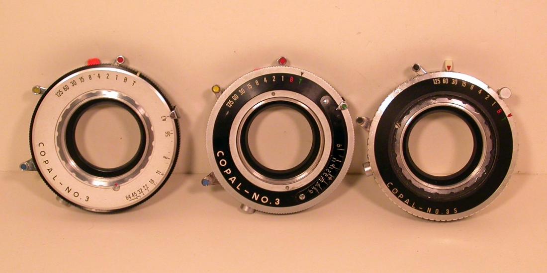

Three different Copal 3S shutters
I happened to have these three shutters laying around today, and thought it might be useful to illustrate the different possible appearances of Copal 3S shutters.
All three are Copal 3S's, even though only one is so marked. All have a 56mm front cell opening, and all use the same flange size.
