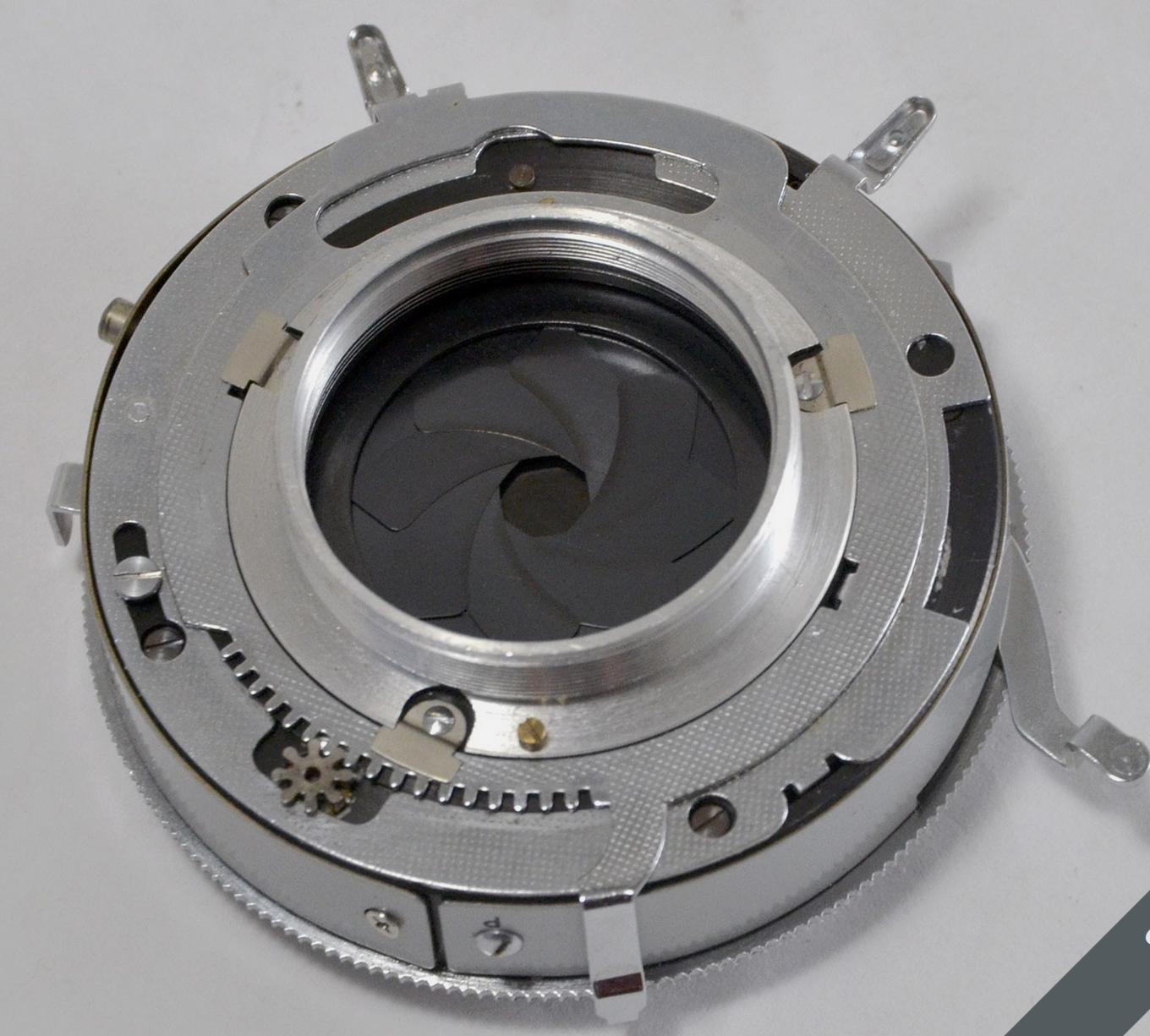

Maybe this will help:
The slow gear train is dirty/greasy.

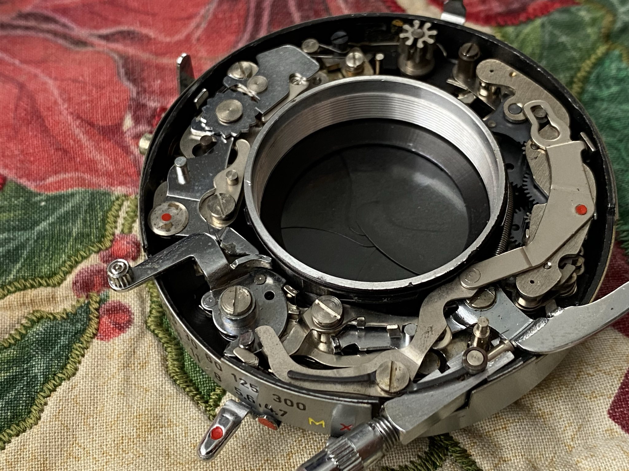

Thanks! I think I'll try opening it up and cleaning/lubing that area while disassembling as little as possible. I saw that the old Retina Rescue site has a PDF manual and am also looking at a couple videos.
correct. this is caused by hardening grease due to age or lack of use and only a clean and relube will help.
I was able to lube it and get it fully working with a few hours effort! It wasn't very dirty inside, but it was dry as a bone.

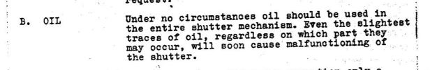

Cleaning rather than lubrication is the answer. You should not be applying oil anywhere. These shutters run dry. Did you read the manual someone else linked to?
I didn't get any oil on the blades. If the oil causes problems in a few years, I can open it up again and clean it with a solvent, but it's working well for now. The level of disassembly required to adequately clean every part of this thoroughly is not in my abilities.
