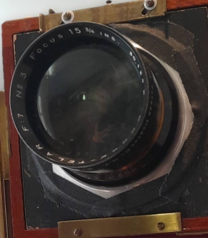

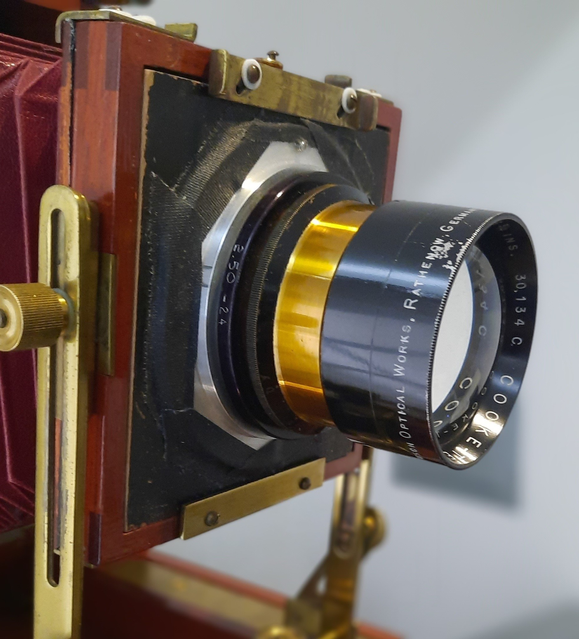

here are some snap shots of the lens

This is a Busch (located in Rathenow) lens. It is a telephoto lens. One property of a telephoto lens is that the flange-to-film distance -- that's what you measured -- is less than the focal length. Your lens' focal length is as marked.
