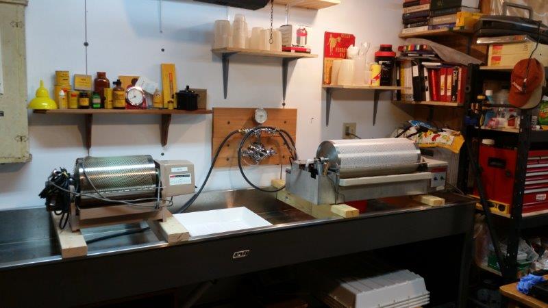

You might be crazier than me :smile: Heres my solution to prints up 20 inches wide. You can develop film on these things if you were (nuts) inclined. I had a chance to get a nearly new Ilford roller processor for developing copy film (litho) camera took 3 x 4 foot sheets , passed through a wall from dark to light. Must have weighed 700 lbs. My wife just shakes her head, I like to think I'm eccentric not crazy. That 10 foot sink was free, delivered to my driveway. Mike
