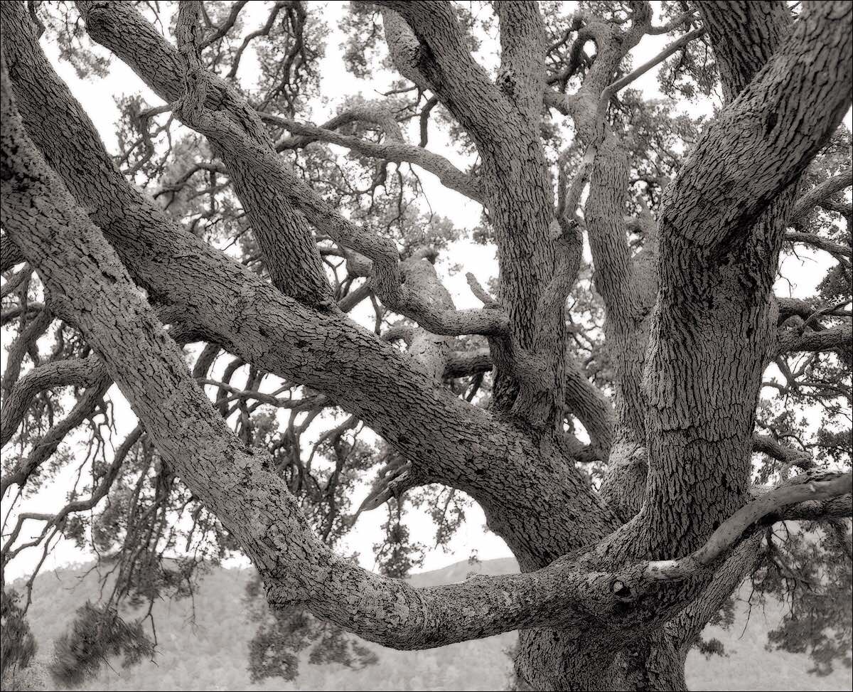

This has not been my experience recently printing my pinhole negatives. These negatives are usually brighter in the center, requiring a higher contrast filter for the edges (usually) and a softer filter for the center. Nearly all of them require dodging and burning. I tried the two exposure thing with no manipulations and it doesn't work. perhaps the distribution of tones in my negatives makes this impossible, but it's hard to say. I'm getting some fairly good prints by the way.

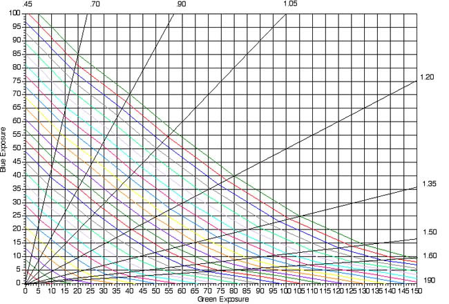

The paper does not respond differently if it gets the blue and green together or in separate exposures.
In terms of a reverse conversion, if you have constructed a table like this then you can go backwards from your ISO(R) value and convert that to graded filter values.
Table shows my ISO(R) values from 0.45 to 1.60 for my various blue and green exposures (separate in time or overlapping, makes no difference).
Don't expect that table to work for you, as you don't know the light source color or exact filter colors or paper/developer combination used to make the chart.
