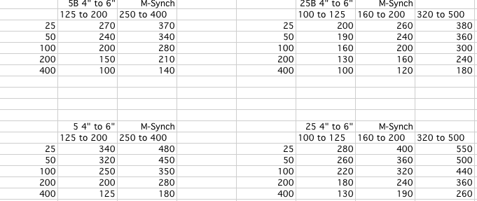

I have a 7" flash reflector and the Guide Numbers for the 5, 5B, 25, and 25B bulbs with a 4" to 6" reflector. How do I convert the Guide Numbers from a 4" to 6" reflector to a 7" reflector?
Should I take the area for a 4" to 6" reflector of 19.63 square inches and divide it by the area of a 7" reflector 38.48 and multiply by the Guide Number?
7" Guide Number = 5" Guide Number*(19.63/38.48)
Or should I use the 4" to 6" Guide Numbers?

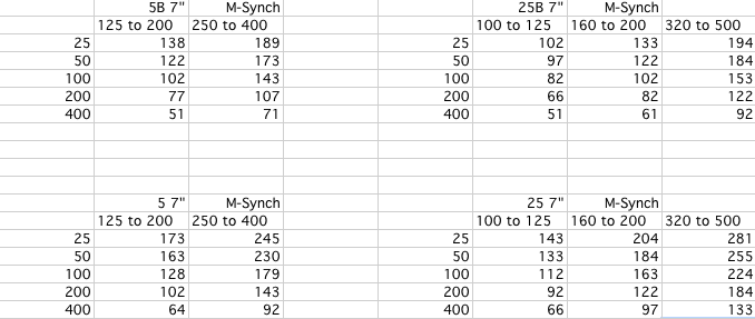

Yes, a 2, 3,5 battery Heiland Research Flashgun with a 7" reflector and a bayonet adapter.
In my kind of arithmatic I'd open 1 stop if using the 7 inch reflector vs the 5 inch with a 25B (for example) bulb.
My calculations seem to bear this out. See attached.
Take this with a grain o'salt since it's purely an academic comment with no experience or success to justify it!
I stopped using salt years ago when I cook because the salt need is more than made up with commercial prepared and restaurant food. :smile:
When do you #11 and #22 bulbs?
Steve
