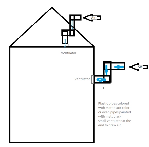

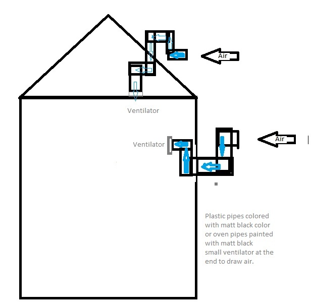

Nice, regarding the vent U shaped pipes, light can't travel around corners so use a sort of U shaped chimney made with plastic pipes or oven pipes, the pipes have to be painted dead matt on the inside. See att. for ideas. (note the pipes sizes are exagerated)
