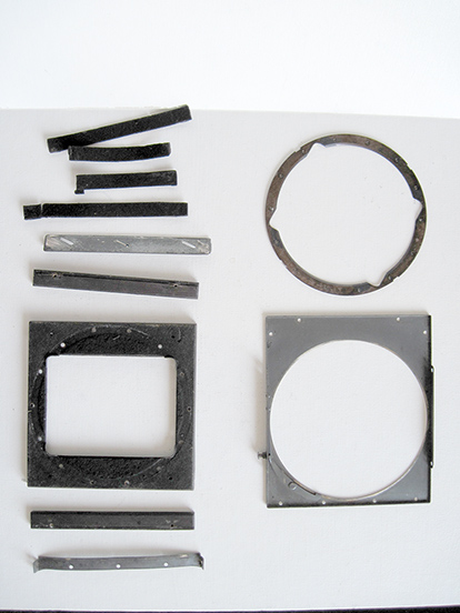

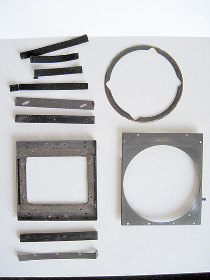

Here are pictures of a Revolving Graflex Back fully disassembled. The back framework is .029 inch brass and the film holder frame is .033 brass. The film holder retainer bar blocks as well as the felt from the film holder seating area have to be removed to access the revolving ring screws.
Picture 1 front view, picture 2 back view.
