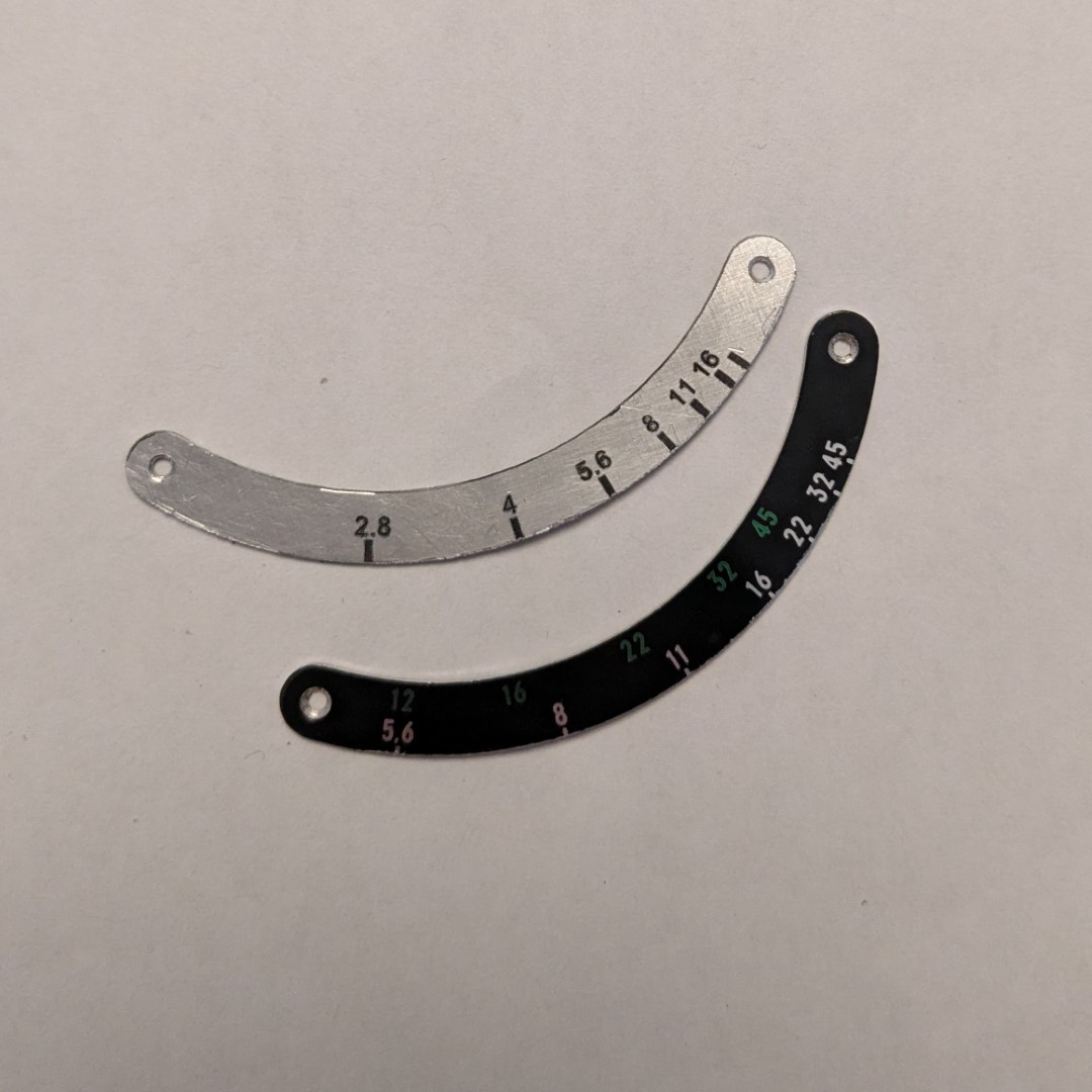

I made a custom scale recently. I stuck a piece of paper on the native scale and marked the f/stops by eyeballing the pupil diameters with calipers.
I photographed the scale on my copy stand and modeled it in CAD. I 3D-printed a few prototypes to test the dimensions and to make some corrections.
I brought the file to a local shop that does laser cutting and engraving. This was nice because I could supply the material and watch it happen. The guy also made some corrections to the DXF file.
It appears that the aperture pointer's angular position is proportional to the aperture diameter.
Great work!!

Nice! I've used mine by manually converting the aperture values using the known focal lengths, but it'd be easier/faster to have a scale engraved. Maybe I'll just make a new on myself. First, though, I need to figure out how to get the original one off...
