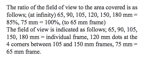

If that has the 62mm lens, I believe Horseman shows the angle of view around 78 degrees on "6x9" format. If you measure your negatives, you will see the film gate is not actually 6cm or 9cm (56x82mm).
I don't have that camera to check but the Horseman optical finders underestimate the film edge. This allows enough room to overlap the image on the easel blades when printing and not lose anything.
