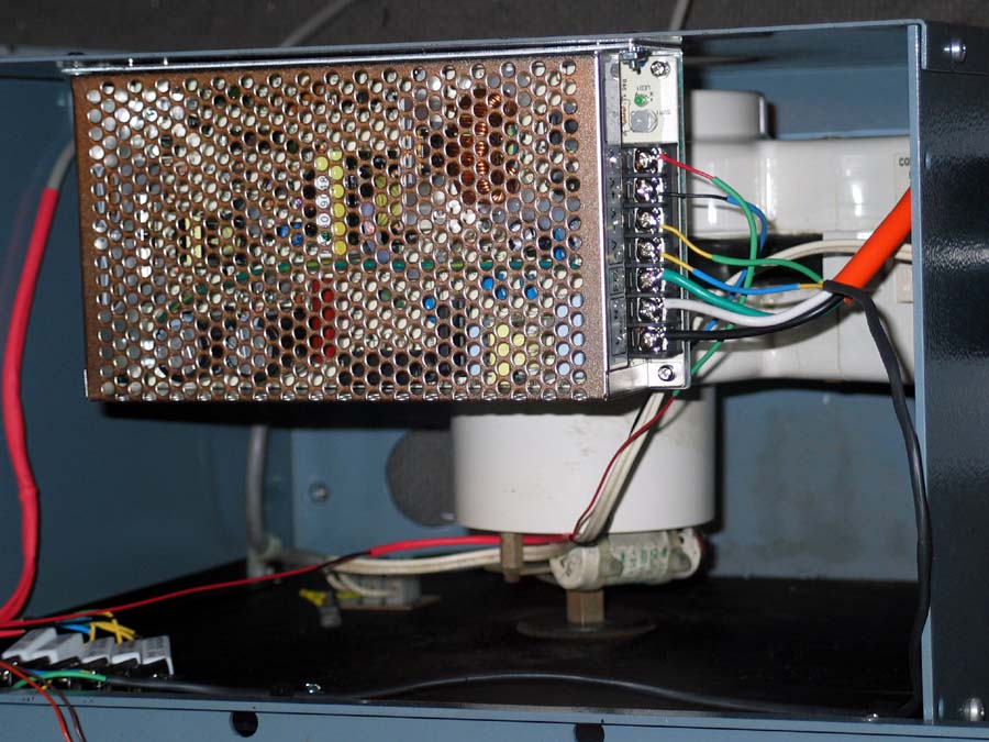

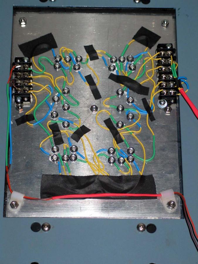

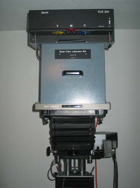

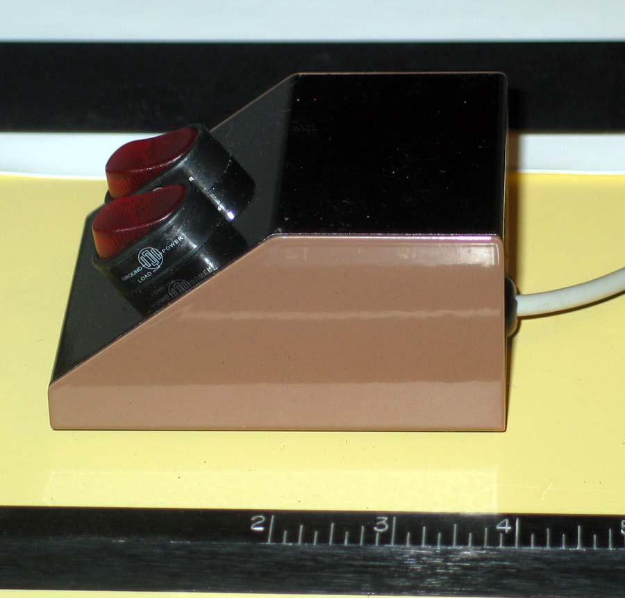

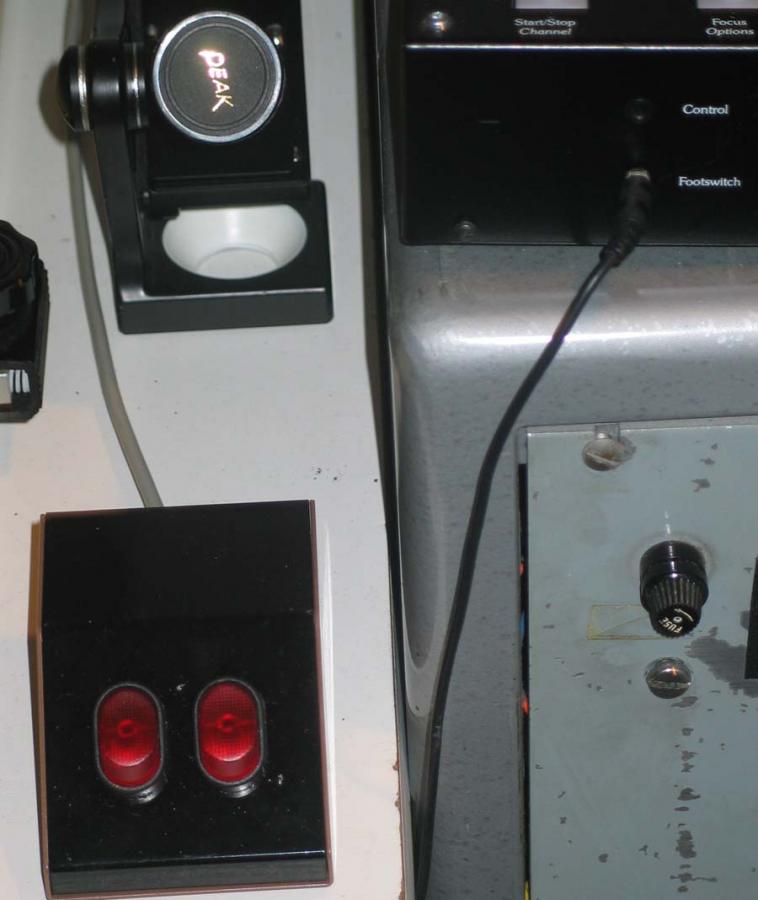

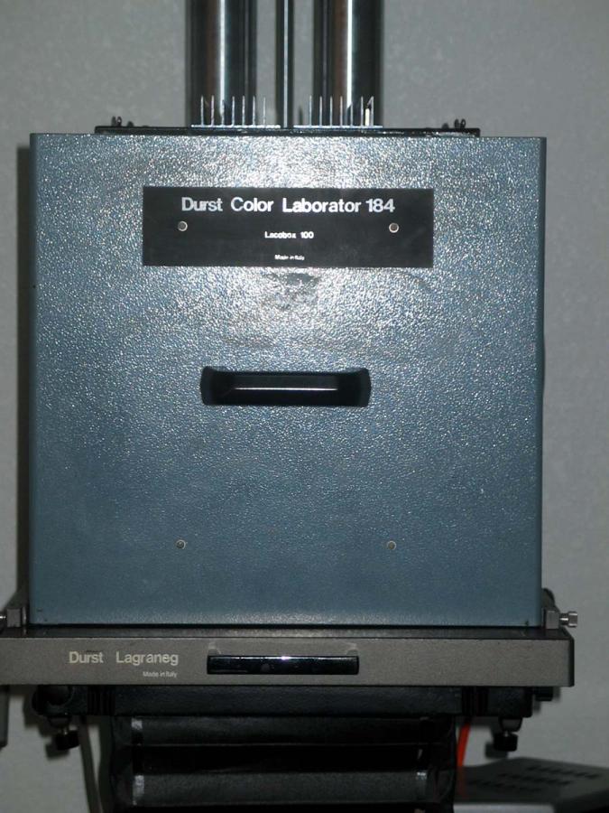

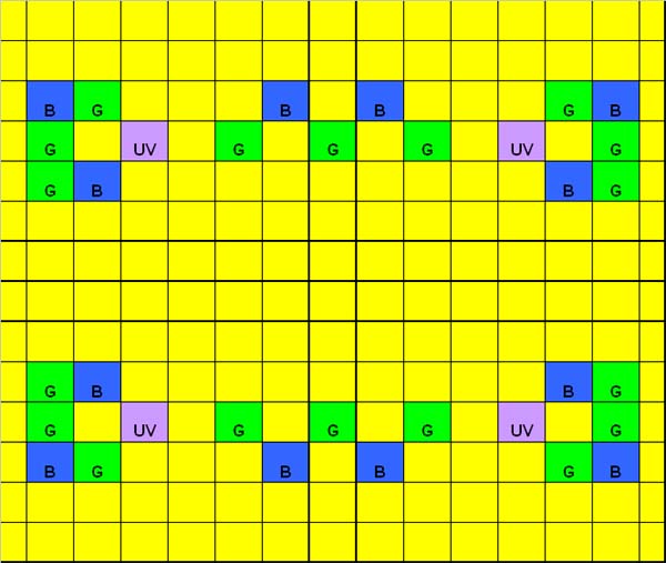

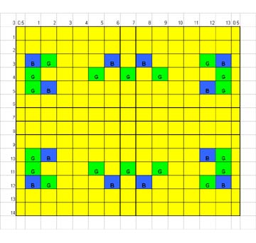

The Durst CLS 301 was a great head to convert. There is ample room. The head is well constructed. Each panel can be removed easily for access. The mixing boxes are heavy drawers lined with highly reflective aluminum so the light distribution is very even.
Also there was no guilt. The CLS 301 really sucked as a 10x10 head since it was designed for the 5x7 138 chassis and fitted, as an economy head for 10x10, to the 184. It only cranked out a whopping 600 watts of quartz halogen light. So it was well under powered for 8x10.
The basic lighting design is 3 arrays of 6 green Luxeon III LED's, (18) and 2 arrays of 6 royal blue Luxeon III LED's, (12). The power supply is a dual channel 24 volt regulated DC. Each array, per electrical specifications, was terminated to ground with a 1 ohm resister. The array calculated to 1 watt dissipation, but I used 5 watt power resisters. It is cheap insurance.
So each array looked like this:
24VDC => +O-+O-+O-+O-+O-+O- 1 ohm 5 watt resister.
I built color coded wiring harnesses and used terminal blocks to facilitate assemble, testing and repair.
The LED layout was inspired by Huw, but I slightly modified the layout to better accommodate the 10x10 head. I hand-wired my board, the LED's attached with high thermally conductive adhesive to an 0.1625" thick aluminum board with the finned heatsinks attached with the same high thermally conductive adhesive. A good daughterboard with traces would have greatly simplified the assembly and cut my LED losses.
I built color coded wiring harnesses and used terminal blocks to facilitate assembly, testing and repair.
The LED’s were laid out on a 10MM grid. Huw calculated this pattern to provide even illumination for his DeVere 504 5x4 conversion using Luxeon I’s. I used the essential layout with the Luxeon III'x to accommodate both 5x7 and 10x10 mixing boxes on the CLS 301.

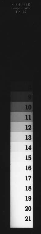

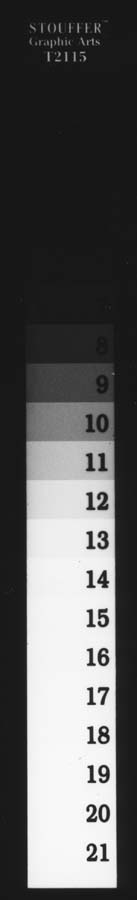

The saga continues!!!! I bumped the Hard contrast range into Grade 5 by adding 4 1watt, near UV/Violet LED’s, (400nm). (See the grid attached for placement.) I ran step wedges to test the contrast. I used Ilford MGIV RC. Looks like I am getting about ISO 65, so well into Grade 5. (See wedge attachments.)
VC paper was designed for tungsten light sources and is sensitive to below 400nm wavelengths, that is, sensitive to UV light. Tungsten and fluorescent light are broadband and extend into the UV range. The very tight spectral response of the LED’s requires more thought to the paper sensitivity and contrast range. One of the concerns in using LED’s was the inability to get to Grade 5. The Phillip’s Royal Blue produced the hardest contrast, but, in my tests, only got into the lower Grade 4 range.
We all must be concerned with using the near UV wavelengths. There are some basic safety procedures to avoid issues. Do not look directly at the lit LED, even for a few moments. The spectrum of these LED’s is very narrow with the peak at 400nm. This is really violet and the short wavelength at which light is normally categorized as “visible” for the human eye. But never forget that you only have 1 pair of eyes and always proceed with due caution
The Soft Grade is very extended, about ISO 215, Grade 00 with MGIV RC. I will run some tests with non-extended range papers, as well. I am using a 21 step wedge. I would like to try a finer gradation, as I narrow down the spectral response.
The Hard is now about .5 stops faster than the Soft. I may try to achieve a better balance by removing some of the Royal Blue LED’s. Although the near UV LED’s are not “as powerful” , in wattage, the shorter wavelengths are higher in energy.
The head is really nice to print with, fast, quiet and cool! The elimination of the fan noise and the head heat is a true joy. I did not realize how much I had “environmentally internalized” all that goes with pouring 1000 watts of mostly heat into the DR.
I have ordered some small modular boards that use the new SMD Rebel LED’s. This will allow easier scalability. The work continues and the LED budget starts to look like the current US Federal budget!

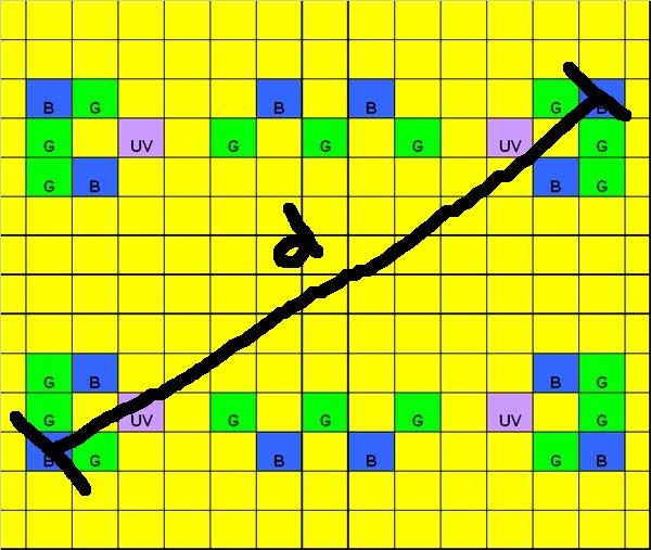

To the OP. Is this enlarger an 8x10 diffusion type enlarger? So there is a sheet of diffusion material between the LED lights and the negative? About how far from the negative is the LED panel?
In the future I may wish to make a similar LED head, so your LED layout diagram is very informative. However, there are no units included, so I'm left wondering the scale of the layout. Do the squares have a certain size to them? If it's not too much trouble could you measure across the extreme diagonal blue LEDs?
