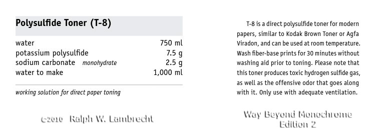

Ralph, do you know the formulation of this direct toner so that one can make it up without buying a kit? Knowing the prescription would also help in experimenting with whatever tweaks might present themselves.
BTW, to all who might go this route, according to Tim Rudman, sulphide toners need to be used quite apart from photosensitive materials like film and printing paper, so get them out of the DR for the toning process, or do that work apart from the vulnerable material.

Ralph, do you know the formulation of this direct toner so that one can make it up without buying a kit? Knowing the prescription would also help in experimenting with whatever tweaks might present themselves. ...
If you cannot get a hold of Kodak Brown Toner or Agfa Viradon, use the attached formula.
... BTW, to all who might go this route, according to Tim Rudman, sulphide toners need to be used quite apart from photosensitive materials like film and printing paper, so get them out of the DR for the toning process, or do that work apart from the vulnerable material.
Good point! For this and other reasons, it's not recommended to store film or paper in the darkroom.

Please listen to Ian (and me) and try direct toning. It will give you exactly what you want, 'a hint of sepia', and it's a lot easier to control.
I intend to. I just don't have one handy at the moment.
... and I do all of my stinky toning outside. I know about the fogging issue.
