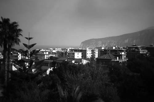

Adox ORT 25 is available in both and can give nice contrasty results without extraordinary treatment. I've played with it in Diafine and Caffenol LC+C, which not unnaturally give very different contrast (example of each attached---the landscape is Diafine). Neither is at the extreme you see with something like Tech Pan, though.
-NT
