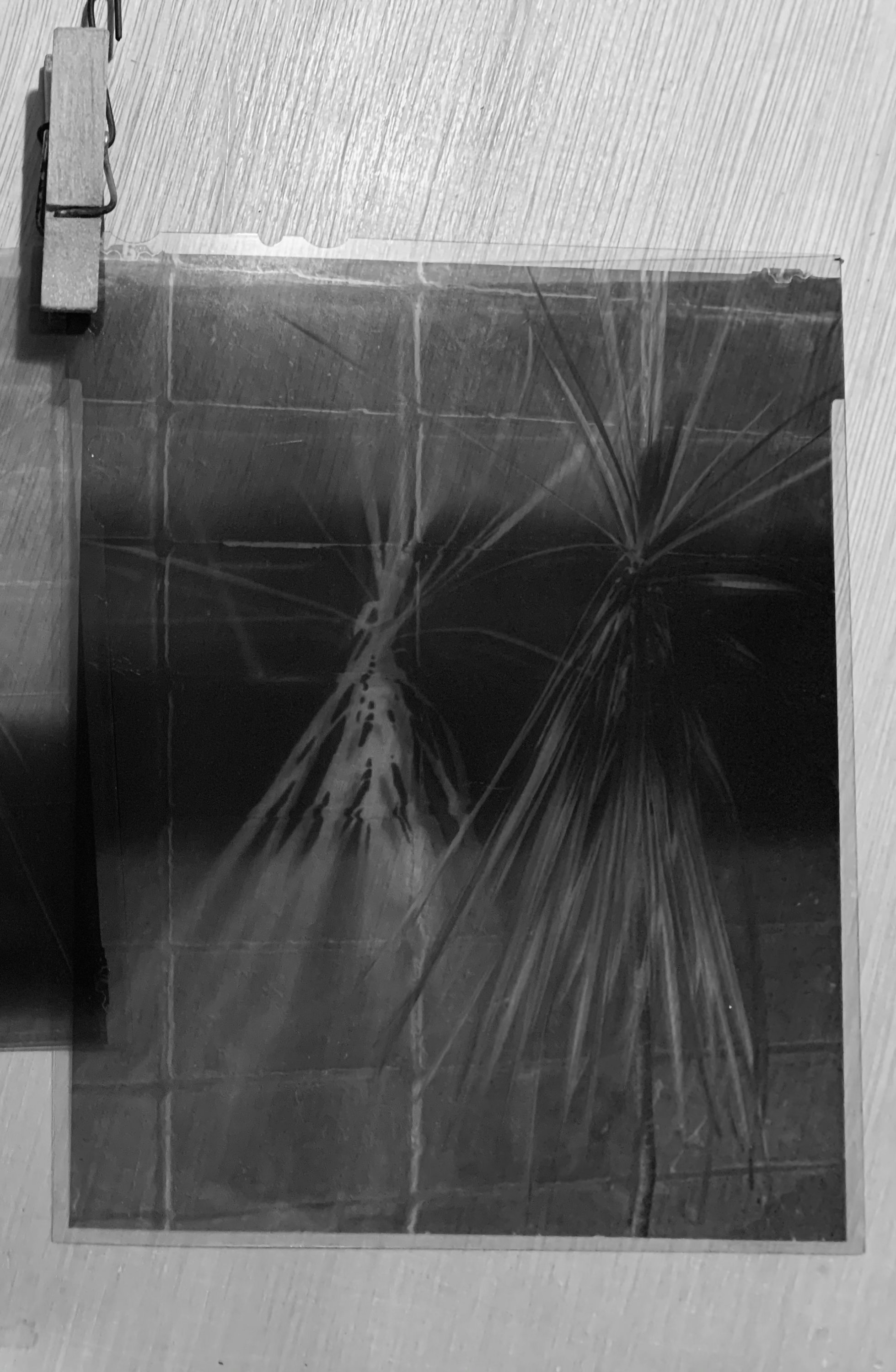

as a way of putting a point, the next step is to make the copy of the shared negative.
The negative contains very clear divisions, two low light areas and one high light area with shadows...
One of the low light zones is near the foot of zone III, with a density of 0.34
so the low light zones will have different times and the high light zone will have a longer time of 0 degree, to obtain detail, if any.
the degree 5 will vary according to the area of the negative...
