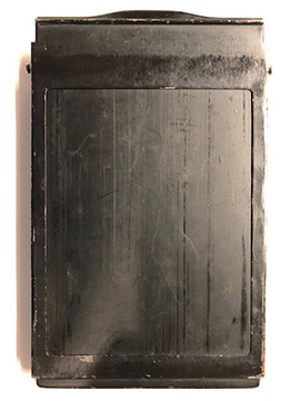

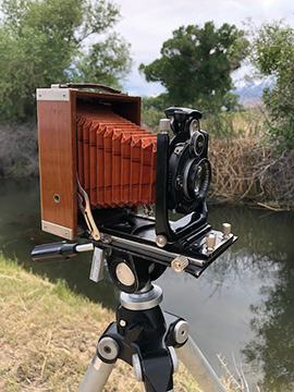

I recently acquired what I believe to be a Contessa Nettel Tropen Adoro with a 13.5cm Tessar. It came with a film pack adapter but no plate holders. I understand that plate holders are not universal. Can someone tell me what to look for at auction or better yet sell me something? I would prefer to shoot film rather than plates so I need the film sleeves as well. Thank you, Joe
The film pack adapter has dimensions 91x136mm.

Looks like a 9x12, and the 135mm Tessar lens was only used for this format. Some Quarter plate cameras were made but the format looks quite different.

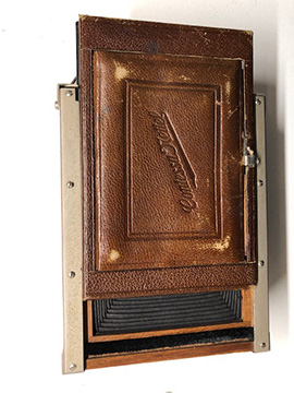

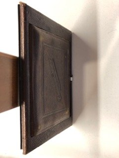

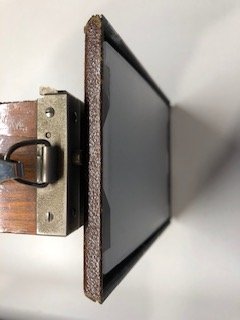

Post some pictures of the edges of the GG focus screen holder and the film pack.
Ian

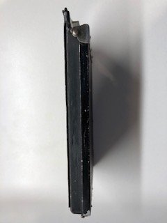

Ian and Andy - Thank you for your assistance! Here are some photos of the GG back and the film pack adapter. I rechecked my measurements...the opening in the film pack adapter is 80x103mm...the film itself, old Verichrome, is 82x112mm. Are film sheaths a standard size? Again thanks, Joe
Looks like quarter plate...hope the photos above suffice.
Yes, it's quarter plate ; I have old Graflex 3 1/4 x 4 1/4 backs, with film sheaths that have these exact dimensions.
Quarter plate cameras made in continental Europe are rare, with backs difficult to find.
Perhaps Ian has some...
