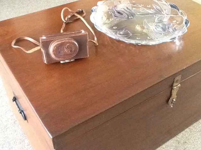

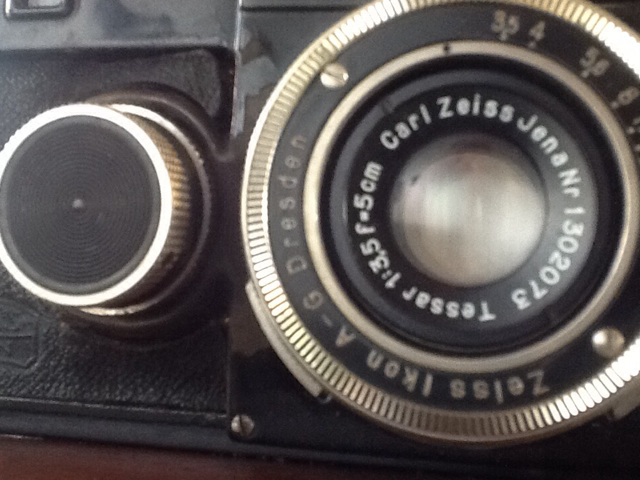

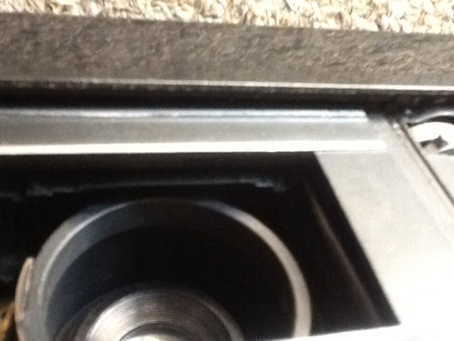

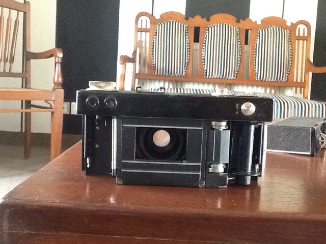

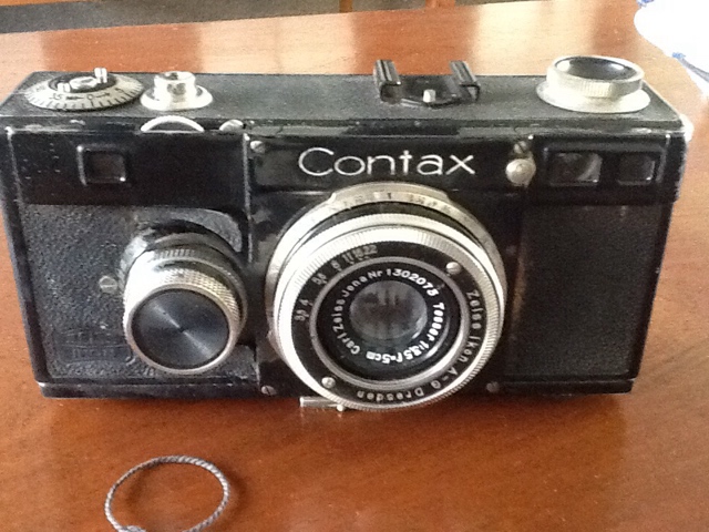

Hi,
I just got my wife's grandfathers camera. I think it needs major repair and refurbishment. Logically it does not make sense to repair such an old camera but I want to find out if it is possible as I am already into using old cameras, I have a pentax me super and a Mamiya rz. Attached are some pictures, I would appreciate if any member can refer a good name in repairing such cameras in the USA.
The shutter doesn't work, the lens seems fogged.
Cheers
Raffay
ImageUploadedByTapatalk1414827158.022886.jpg ImageUploadedByTapatalk1414827174.355908.jpg ImageUploadedByTapatalk1414827192.679672.jpg ImageUploadedByTapatalk1414827222.011940.jpg ImageUploadedByTapatalk1414827235.506117.jpg

Its a contax I and it is a very pretty camera. Here's some more info: https://www.cameraquest.com/zconrf1.htm
The ii and iii models were more popular and I think were nice improvements on the camera. Great focusing accuracy with huge ebl, but you had to make sure your hand didn't cover the rf window on the right side when you held the camera.
CV did make a few modern lenses a little while back, that actually mounted on these older contax models. (The also made a modern bessa that could take the older contax lenses) but now these are very expensive compared to the ltm models.
I can't think of any contax specialized repairmen, but maybe rangefinder forum may offer some suggestions too.
