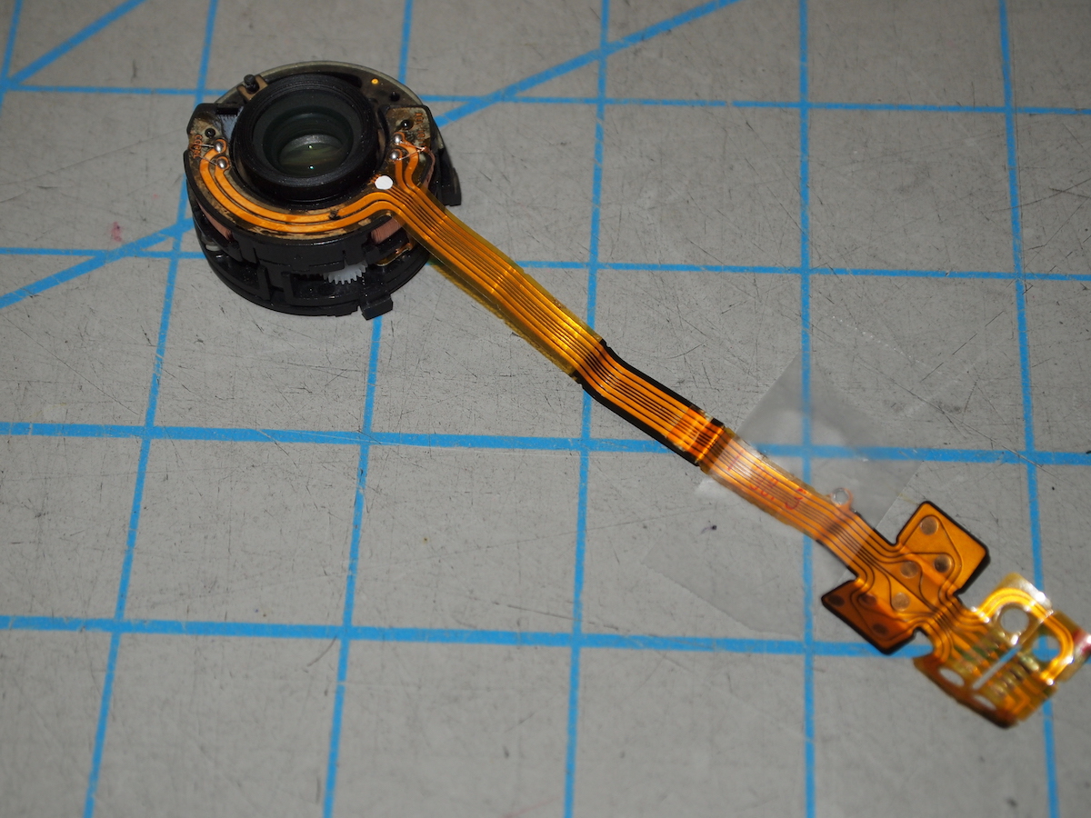

Hey there. There is an issue with the CONTAX Tvs that plagues every copy. The flat flexible cable that connects the shutter to the body folds tightly when turned off, and over time, snaps or desolders from the lens/body. The LEICA MINILUX is plagued with the same issue, and has been repaired. I've found the part number, COPAL AEL-1011, and a supplier in China who can provide the cable. They're on eBay I believe if you search AEL-1011. Unfortunately, the job is a tough one, and back in the day wasn't even attempted. Entire lens units were replaced, rather than just the cable. I scanned a copy of the manual to aid anyone interested in fixing their own Tvs. Please let us know if anyone ends up successfully fixing their camera! The manual only details removing the lens unit from the body. Past that, it's all on your soldering skills.
https://drive.google.com/file/d/1rThdxWiBgYvZaD2PoVJqGq6FdHHQjm32/view?usp=sharing
Included is an image of the entire lens unit. As you can see, the top is just 4 easy solders.
However, when looking at the part, you can see the other extension jotting out from the cresent. That's where I'm afraid that the repair will get dicey. Good luck!
