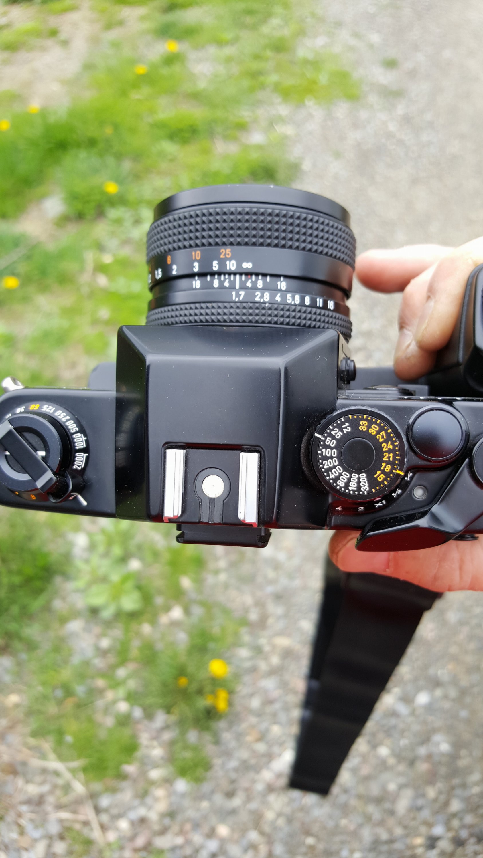

I just bought a RTS and a RX and the are focusing differently with a 50mm lens. With the RTS infinity is just back from the mark as shown in photo 1. The RX infinity is in focus in the viewfinder further back. What could cause this? I tried using the eye correction on the RX but it didn't help.

Funny you should point this out - i just looked at my RTS II (with 50/1.7 planar) and focused using the center spot microprism to focus, and the distance indicated is at exactly the leading of the 0 in the 10m mark.
But to your point, it is a bit disconcerting that whatever this point would be, it is different between the two bodies. Obviously the focal point at the film plane has to be the same

That's what I was thinking. It seems to me something must be off on the RX body. I'm considering just sending it back to the seller and ordering a different one. Unless it's a super easy fix.

I would verify that the focus screen is correct for the model and installed correctly. The mirror position would be second.
Instruction manuals are available at http://www.butkus.org/chinon/contax.htm if you need them.
The focus screen is one of the proper ones. It's an FW-1 which is the standard screen. So that seems to leave the mirror position.
Is there a simple way to tell if the mirror is not positioned correctly?

Although mirror position is not a problem I've had to deal with I would trip the shutter on B, lens removed, and inspect the mirror resting pad for obstructions, debris, or deteriorated/missing stop pad be it rubber or foam.
Upon release I would check to see if the mirror was returning fully against the stop pad/resting pad. Some cameras have been reported to have stop adjustments. Also look for mirror separation from the backing plate.

I also had a focus problem with my RTS. In the viewfinder it looked sharp, but the negatives came out unsharp. The pictures I took with my 137MA and the same lens where fine.
Cause: the mirror fell back to far in the down position because on one side a tiny hub/bushing/ring was missing from the bar/catch it falls back on.
I was lucky enough to find that tiny hub/bushing/ring inside the camera. I glued it back on, and the RTS has been focusing fine ever since.

To be honest, I'd have them both checked out, and also make sure there's not a hidden diopter installed somewhere - I've had an RX, a pair of 167MT's, and an RTS III, and in all four of them, infinity was infinity on the lens. These were very precisely made, well-built machines and they shouldn't be off like that. I'd also have the lens checked out- the lens elements could be out of alignment if you're seeing an issue on both bodies, just more extreme on one than the other.
