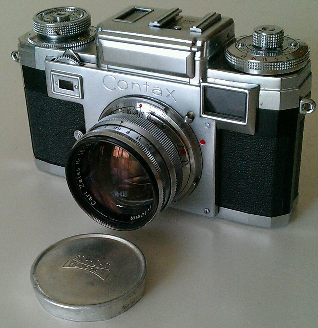

The exquisitely engraved markings on the chrome knobs and the use of gear-driven shutter slats is why I bought this IIIa:
