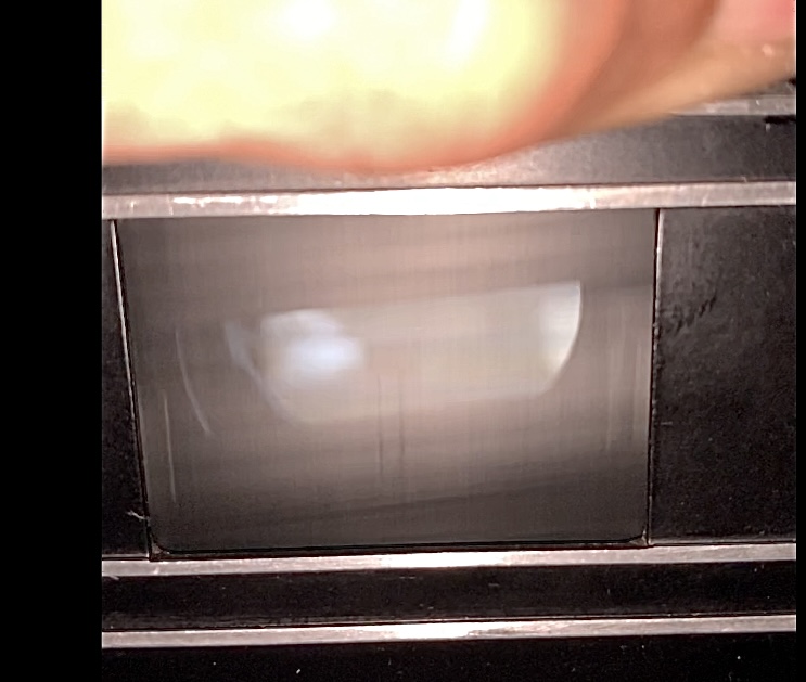

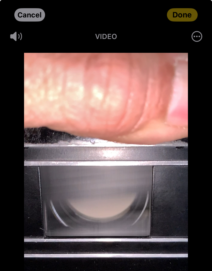

I just discovered something using my iphone, I can do a slo-mo video and I can see the opening between the 1st and 2nd curtains. The high speeds are more blurry because of the speed but slower speeds look pretty good. Here are a couple of screen shots. The 2nd one is at 1/1250. Does it look normal?

Hmm the curtains are not parallel the film gate opening ... so I am guessing a problem with curtain strap on the left ... it is not traveling downwards properly.

Wouldn't it be fine as long as the opening is the same as far as exposure? The opening looks parallel to me.
