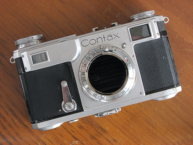

These are the meterless models. First is the Contax II, 1938 Dresden production. Prewar, these cameras were made in Dresden and the lenses were made in Jena. There are some very rare postwar cameras made in Jena that are of the prewar design.
2nd is the Contax IIA black dial variant, 1953 Stuttgart production.
What exactly is wrong with your camera? I restore my own but I cannot realistically commit to taking other people's cameras on as extra work. If you PM me, I may know somebody in Europe that could get your camera going much quicker than November.
