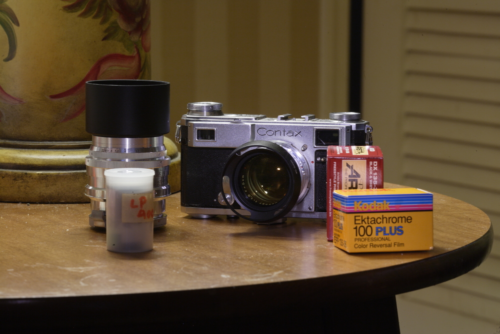

Contax II with 50 Sonnar and Russian Jupiter 9
