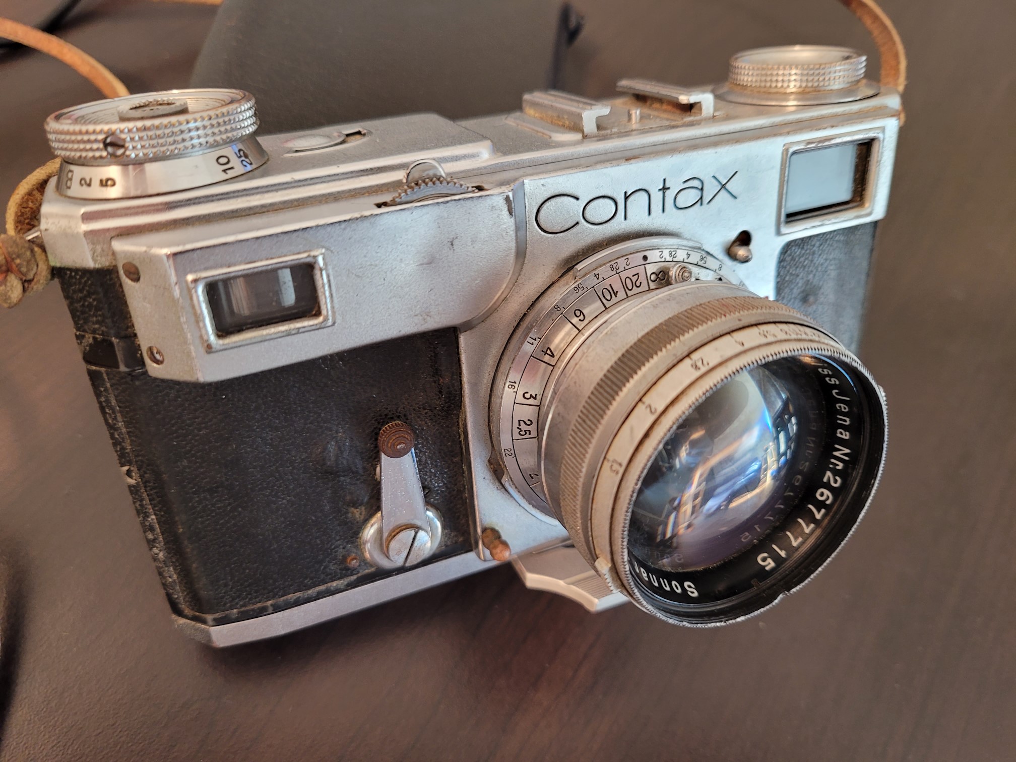

I just bought a Contax ii which includes a Carl Zeiss Jena 50mm f/1.5 and I have yet to determine whether the shutter speeds are accurate (just finishing up my first roll, so we'll see. Short ones sounded much slower, but fast ones felt right).
Regardless, is there a way I can polish or clean up the exterior metal on the lens barrel and camera body myself? I took some time wiping some imbued dirt and stuff in all the corners with some 70% isopropyl alcohol, and I used some glass cleaner on the rangefinder windows. Further, I was given some Kodak lens cleaner for the lens and I used a microfiber cloth to get rid of some dirt that had accumulated on it.
The edges of the dials are shiny, but everywhere else is quite dull compared to more pristine photos I see online. And there's some dirt caked in spots, etc. I wouldn't know how to approach the leather. Short of sending it in somewhere, what stuff can I do for it?

For the caked on dirt (as seen on the cold shoe, say), try a (dry) toothbrush. Other than that, I got nothin'. Seems like you've got one with a lotta 'patina'. If it exposes and focuses well, I'd just enjoy it as-is; no Contax I've ever had did those 2 things.

Try toothpicks and spit. Take your time and go over a small area at a time.

Don’t have a Contax II, but the post war IIa was chrome plated, so a good metal polish should work.

Baby wipes clean very well.
However, you have quite a bit of corrosion on that camera, which won't clean off.
I used a toothbrush all around but it didn't clean much that a microfiber cloth hadn't already picked up. Nothing was too lightly caked that it would brush off. But I overlooked the cold shoe, I'll give that a pass, it might be better suited there...
Regarding working order, I'll see soon. But things are looking promising. The lens clearly works and is pretty clean with no haze, but a tiny bit of mold. I shot a roll which I'll send off to develop today, but afterwards I tested some shutter speeds using my phone's slow mo mode and they agreed quite well for the speeds above 1/25.

Would metal polish also get the corrosion? Or should I try some vinegar or baking soda or something? (I forget which corrosion remedy works)
The little knob on the self timer and whatever that thing is poking out at the corner of the bezel around the lens are the most corroded parts, the rest looks as you see elsewhere. The self timer doesn't work at all, actually. Not like I have a pressing need to use it.

A little vinegar can't hurt. Just on a q-tip. Since the camera has clearly been in a not-great environment, I would expect a shutter ribbon to break soon. If you can use it at the higher speeds, that's great. Check the rangefinder by seeing if it matches with the lens at infinity. If the patch is responsive over the travel of the lens, and it matches at infinity, it's probably good enough to use.

As suggested, a dry toothbrush and toothpicks,
Or careful wipe-downs with q-tips and alcohol.
For cleaning brushed chrome surfaces I found that ceramic stove top cleaner works great. But it will get into all the nooks and crannies if you're not careful.

Errr, I hope I didn't rub it off... I used this Kodak lens cleaning solution and a microfiber cloth. Looking at the photos, unless it's the mediocre 2MP minilab scans and the Fuji 400 I used playing a part, yeah the contrast isn't the best sometimes. But I'm not sure what else the coating is meant to improve. I do see a slight glow around some peoples' light shirts in the sun a couple times, but I don't have any outright flares it seems. I only shot a few photos directly towards the bright sky and yet I only see a glow emanating around it some.
I had a go with saddle soap on the leather and maybe I'm not using it right. The part I tested ended up a tad drier and less bumpy looking, with a bit less luster. Quite a bit of black came off. Maybe cleaning leather is supposed to look like that, I know cleaning the leather earcups yields yucky residue that is also very dark, but I'd just like to be more sure that I'm doing it correctly.

Concerning the ceramic stove top cleaner I mentioned, it is non-abrasive. It's just good at picking dirty out of the brushed chrome surface.
