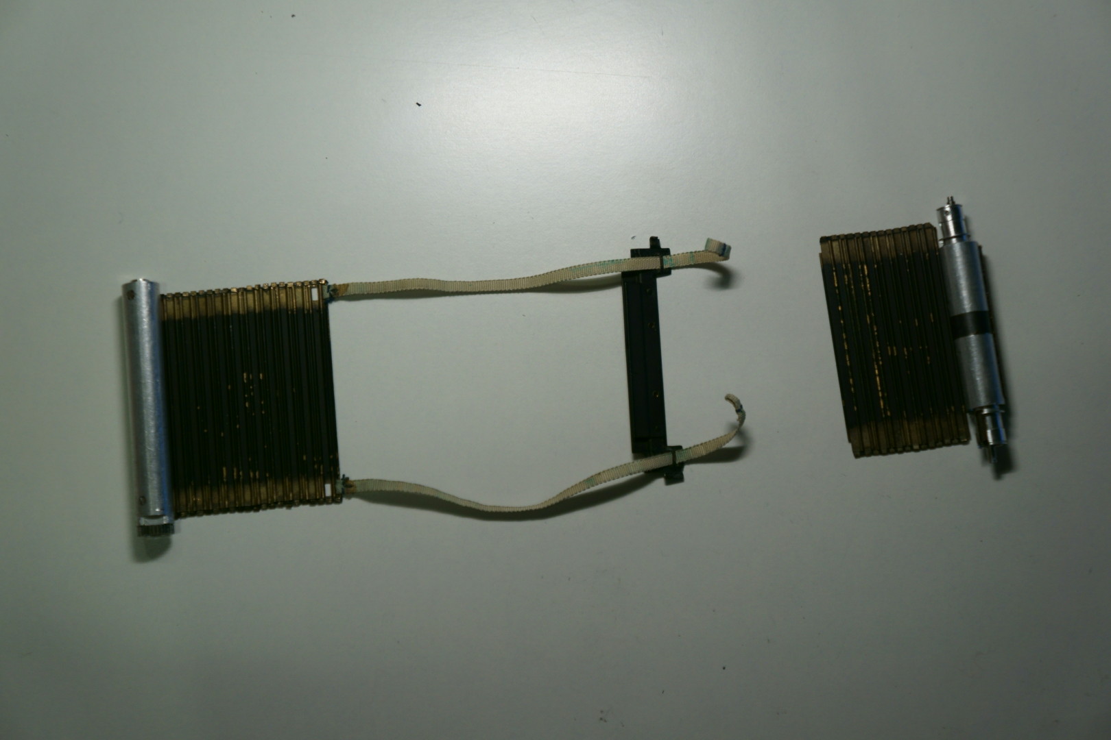

Being familiar with the Kiev rangefinders (Contaxes made in the FSU) I had no reservations about buying a cosmetically beautiful Contax III with a broken shutter.
I was confident that I could fix it.
Upon disassembly however I found that the leather strips alongside each edge were disintegrating.
Perfectly understandable for a camera made in 1937.
How to fix that ? I was stumped. Searching the web for a solution yielded nothing.
A lot of info on replacing the shutter tapes but nothing on the leathers that I could find.
Having never before posted in a photograpy forum I tried registering in the Ragefinder Forum to ask for help but was rejected, believe it or not, because there was no online evidence of my interest in Photography !
I am sure I have been messing with photography since before the administrator of that site was born !
This forum on the other hand appears much more welcoming to new members.
Back to the Contax, at least temporarily I installed a Kiev shutter while I hopefully restore the original one.
Thanks to this topic (there was a url link here which no longer exists)
I started considering options such as monofilament line in place of the leather.
I must remind you, these leather strips are extremely thin and narrow, in the order of 1mm wide and 0.1mm thick.
Because of my desire to restore this camera to as close to original condition as possible I decided I was going to try to reproduce those leather strips.
I can now report that it is perfectly feasable ! In fact it is a lot easier than it appears.
I will be attaching a little guide with some images.
I hope this helps somebody and it helps preserve this wonderful camera.

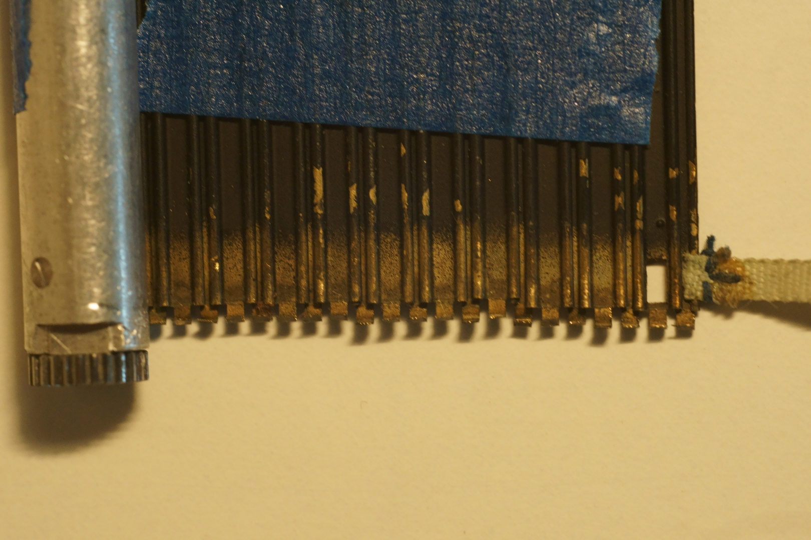

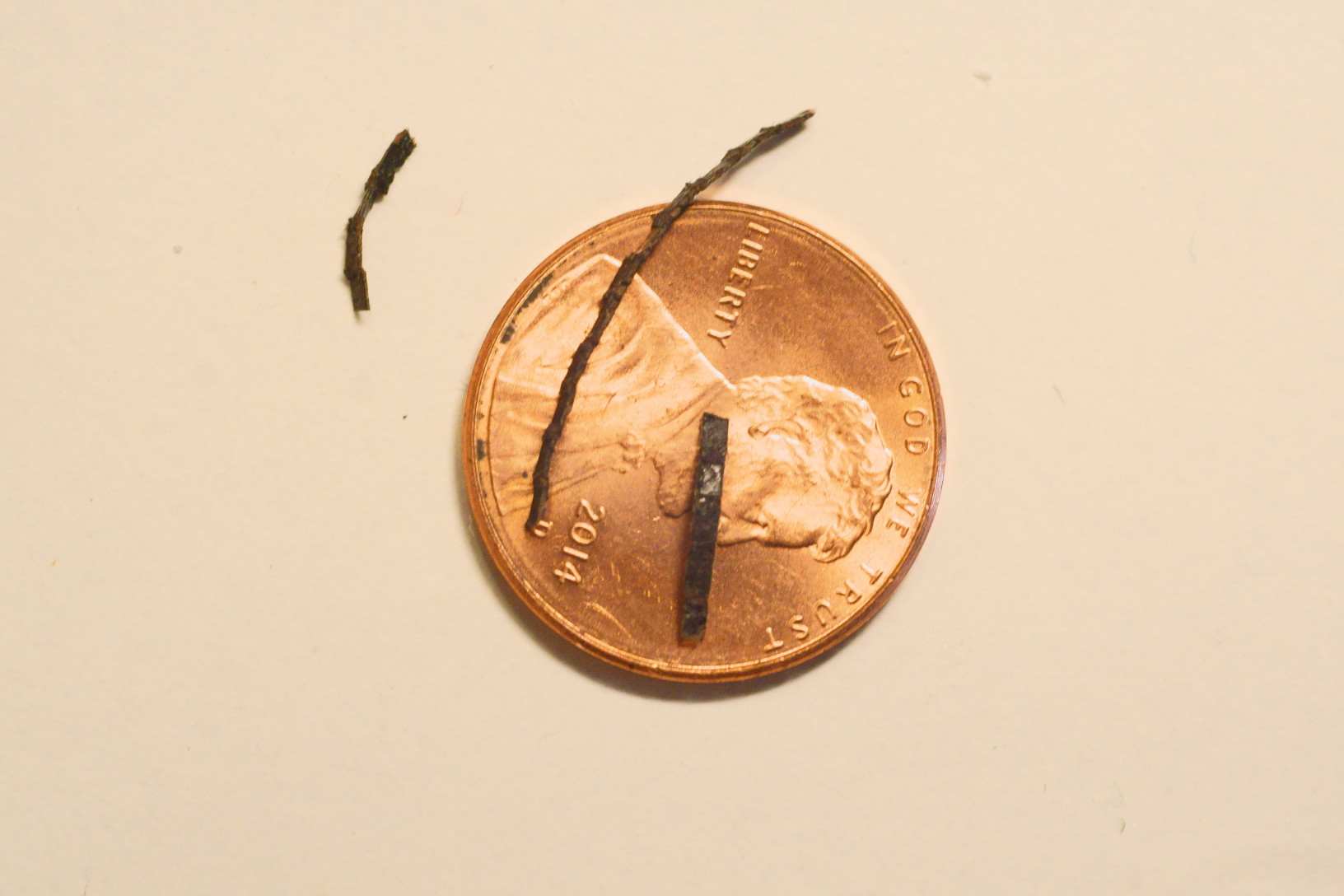

Restoration Contax Shutter cont.
The first image shows the little tabs on the sides of the curtain after being pried open.
I used the tip of a sharp scalpel to get underneath the tabs and bent them up 90 degrees at the most. In hindsight only about 45 degrees or so is needed.
The old disintegrating leather strips fall out on their own. They are not glued at all.
The second image shows what the strips look like.

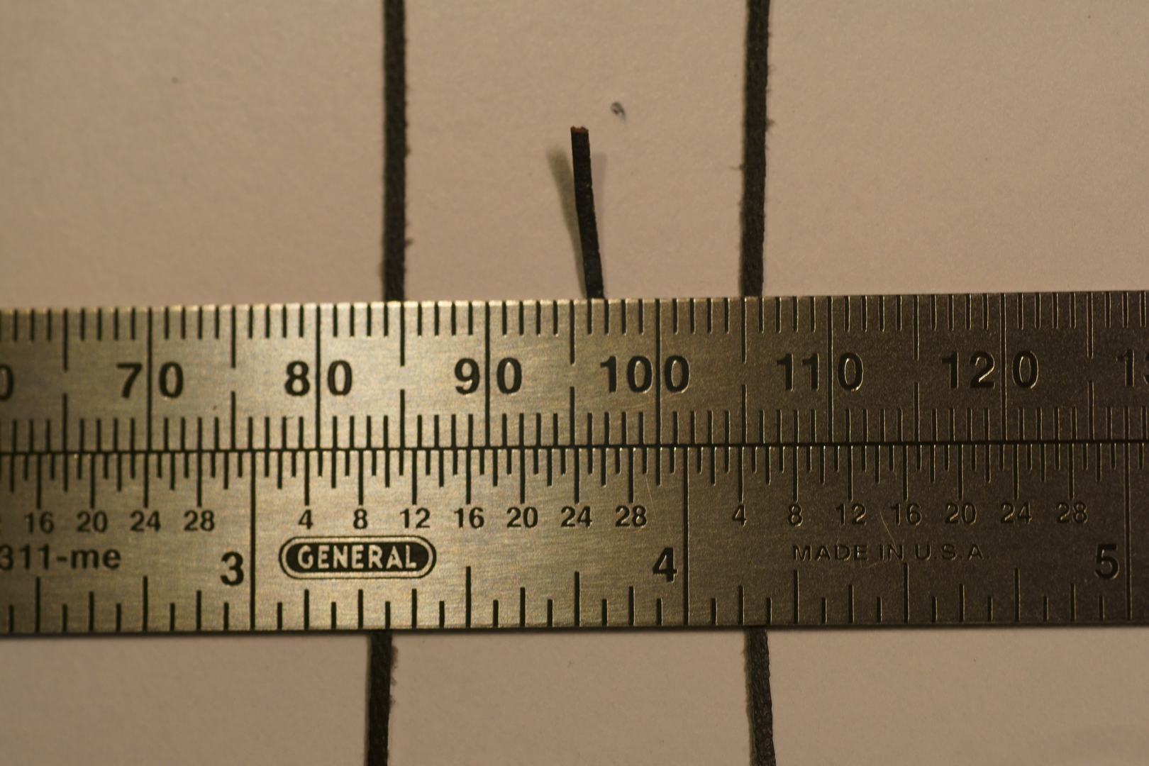

Restoration of Contax Shutter Cont.
First image shows the cutting of the strips.
Next image shows the strips with the desired dimentions of 1mm in width and approx .1mm thick.
The one in the middle is the original one.
The 2 on each side are the new ones.

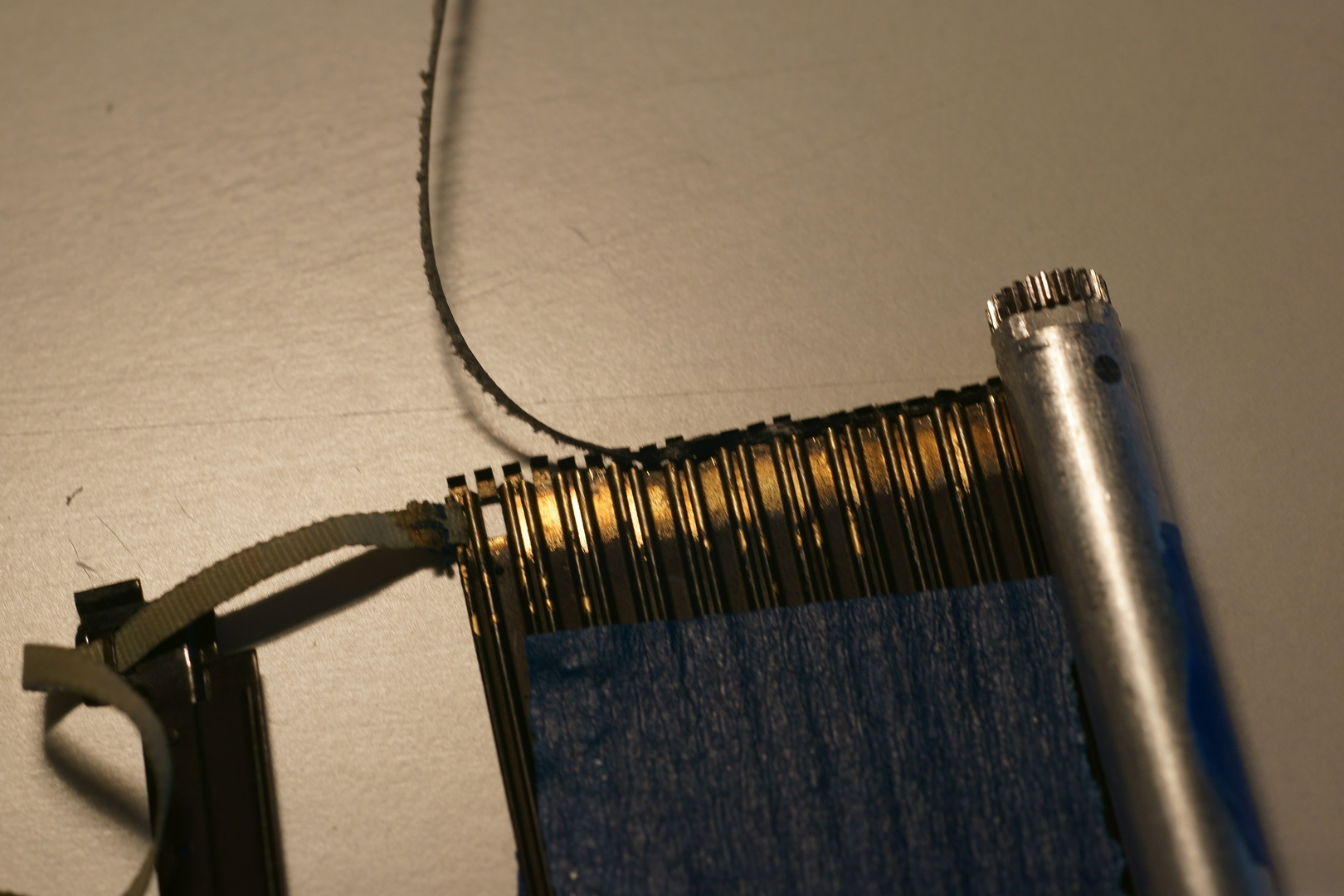

Milandres
Apr 4, 2015
15
US Pacific n
First image shows the fitting of lhe leather strips and the last image shows the end product.
I must say the repaired curtain feels exactly like the original. Very supple and it drapes around the roller beautifully.

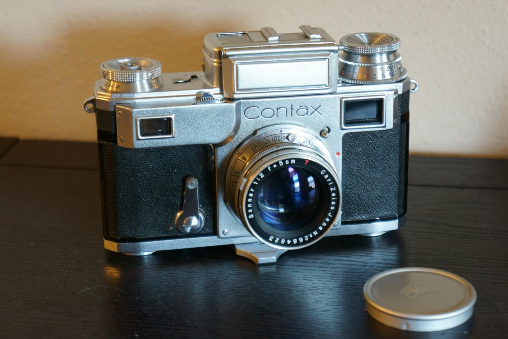

Well, it is done. My first Contax restoration.
Everything turned out well, all speeds working.
Took a lot less tension than my Kieves and the winding is so effortless !
Not bad for a $100 find in an antiques store. Including the lens, which incidentally is an early coated version.
According to the shop owner the camera belonged to an old Swedish gentleman.
Now to shoot some film !
