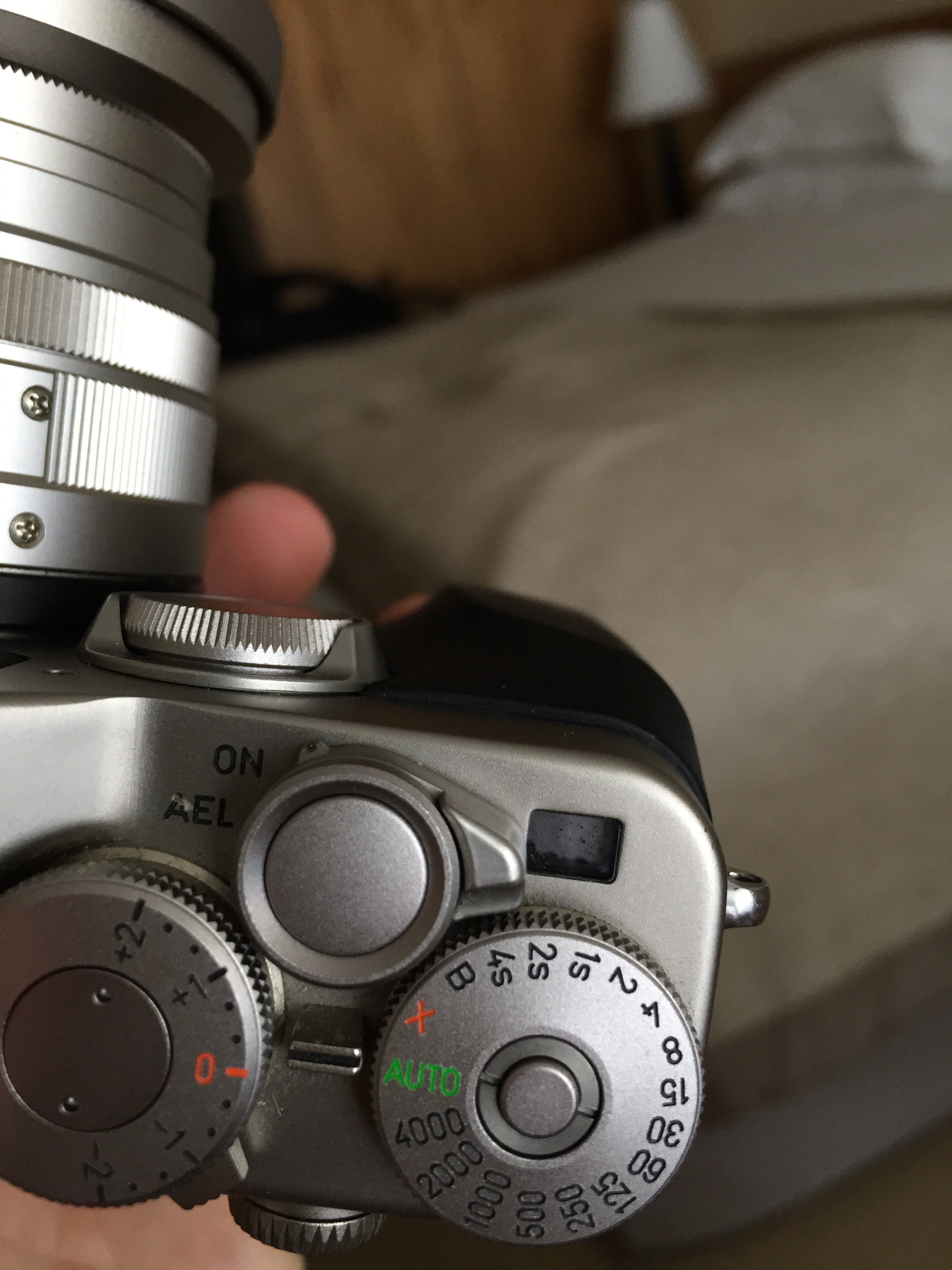

Hello,
My Contax G2 has suddenly become unresponsive with no shocks or anything, and seems basically stuck in a middle of a shot. Doesn’t respond to any button or the on/off switch. In the exposure counter there are dotted lines going around the perimeter. Is it a common problem and is there a way to help it? Is there maybe a way to reset the camera?
Thanks in advance and hope there is a solution.
Alexandre

I did remove the batteries for overnight, but I haven't inserted any, new or old yet.
Will do it and post what will happen.

Also maybe try pushing the manual rewind button on the bottom with a toothpick or pen. You might sacrifice the current film in there but at least it might reset the camera.

I'm on my way with the fresh batteries, but I tried the rewind button and it didn't respond either.

Richard!!! Thank you so much! I know that I should have tried this sooner but in any case, thank you and I am so grateful! All works and the camera is reanimated!
