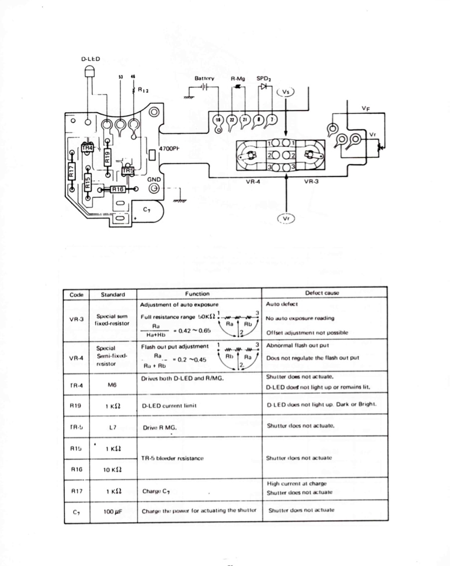

I've looked high and low for this information, but I haven't been able to find out how the light meter on a 139Q is calibrated - mine is reading one stop too fast (underexposure). I see three trim pots on top of the pentaprism (labled 1 3 and 5 I believe), and I presume that one of these adjusts the offset for the main light meter (are the other two slope and TTL flash offset?).
Also, if you have any ideas about troubleshooting TTL flash metering, I'd love to hear about it - my TLA 360, which works fine on an RTS II, just fires at full power on TTL mode with my 139.
Does any one have a service manual?

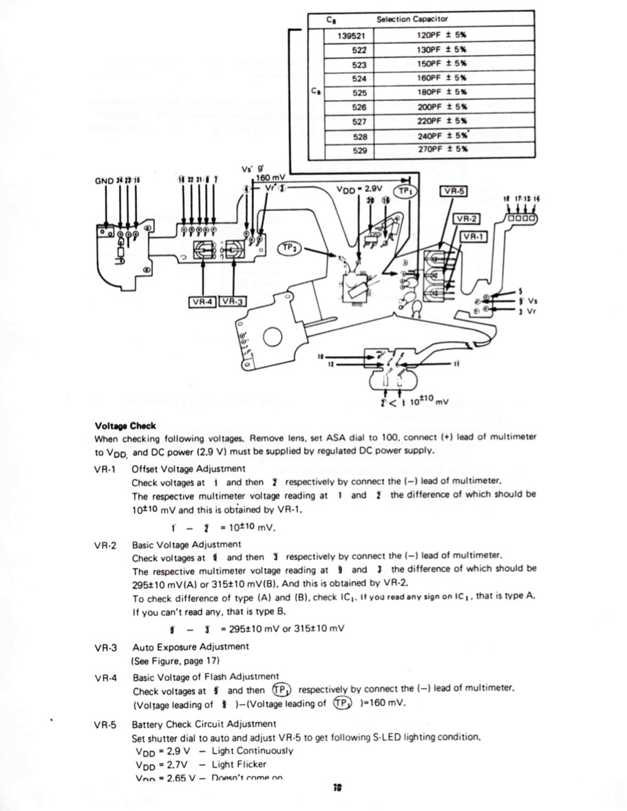

Do you have the service manual? Only certain things can be adjusted.

Huh, so it sounds like the offset can't be adjusted... that means a problem with the ISO selection reading or the minimum aperture reading the I suppose. Those pages are very useful, thanks. If the manual is available somewhere online, can you send it to me?

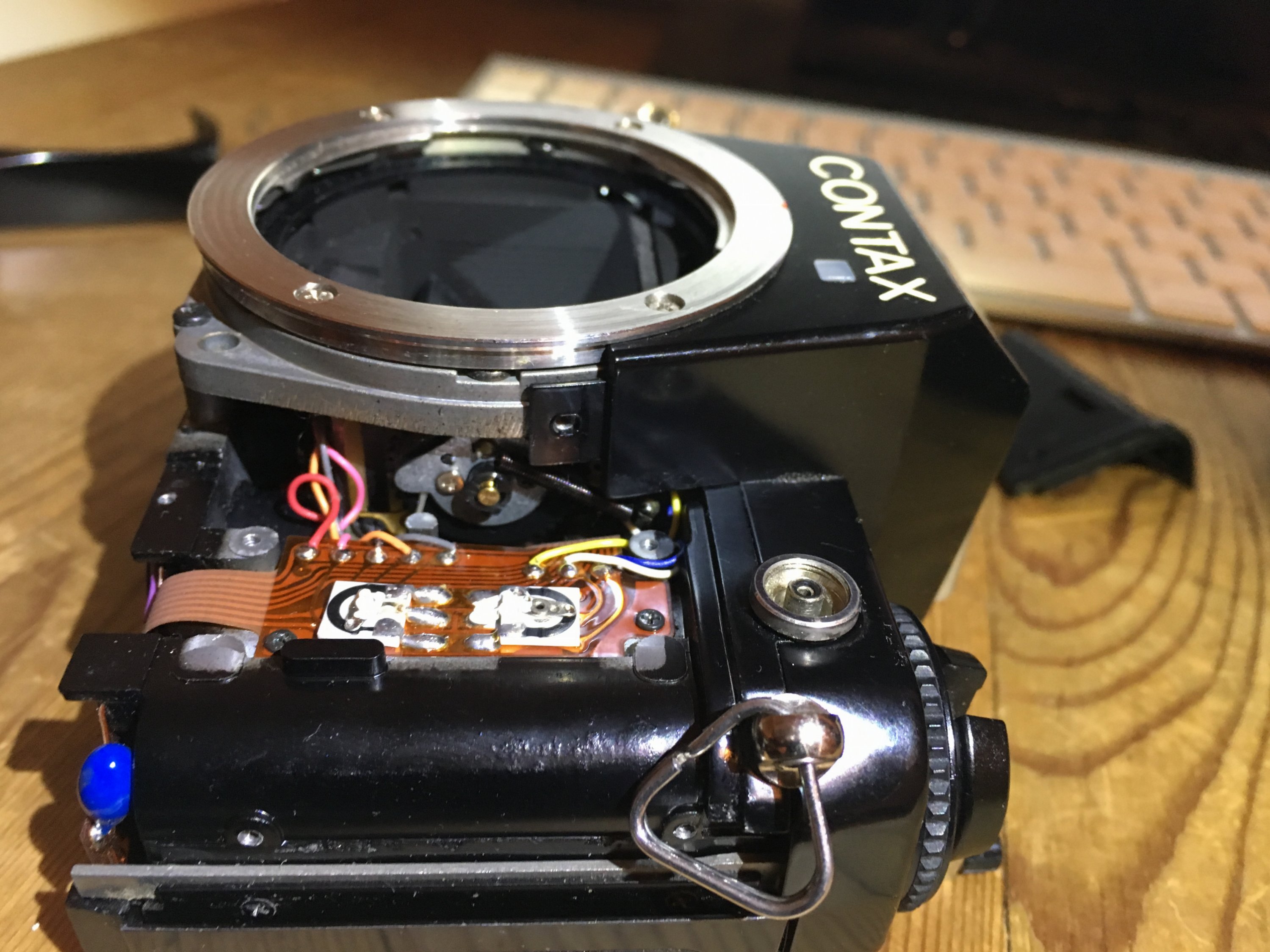

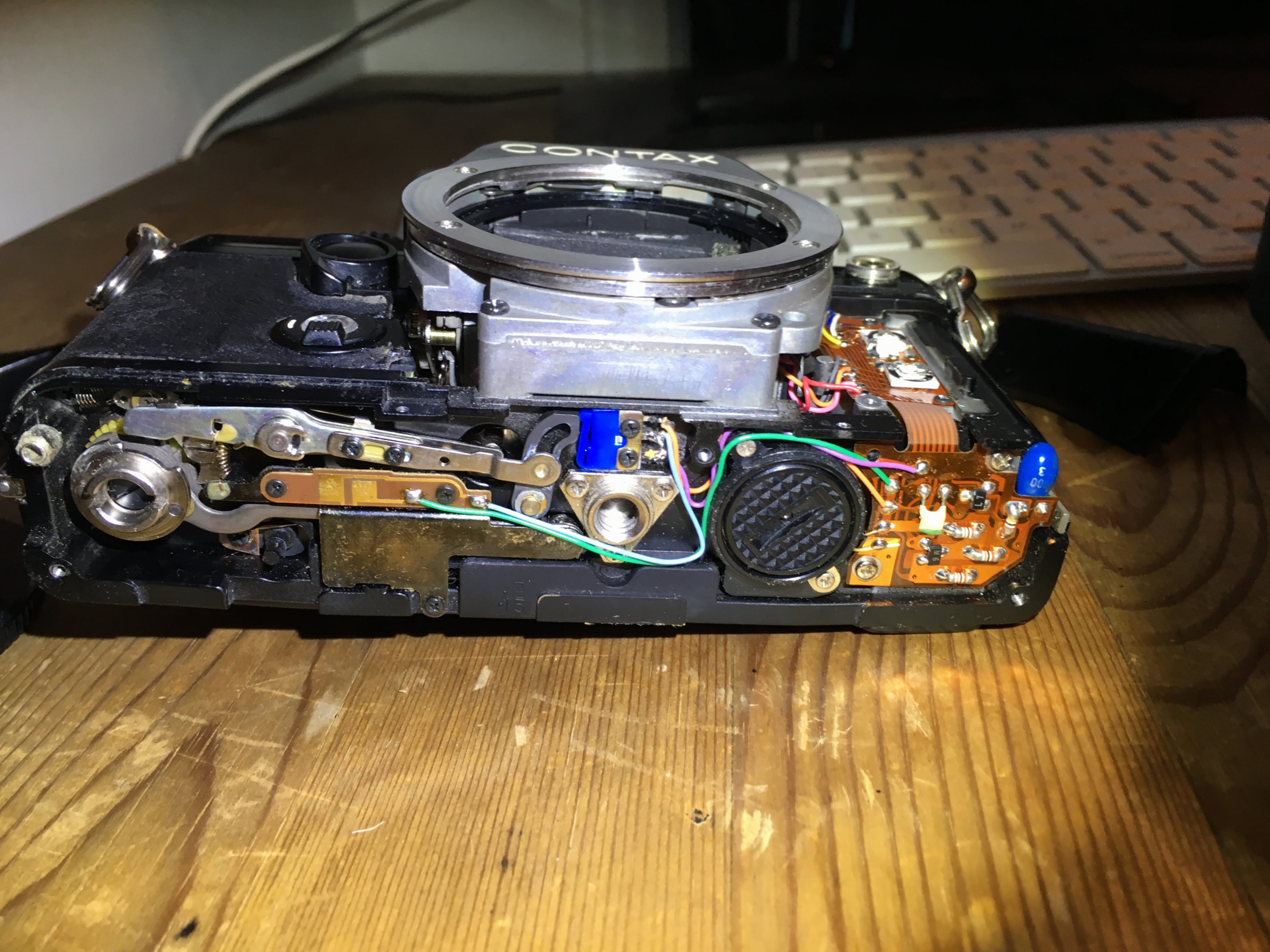

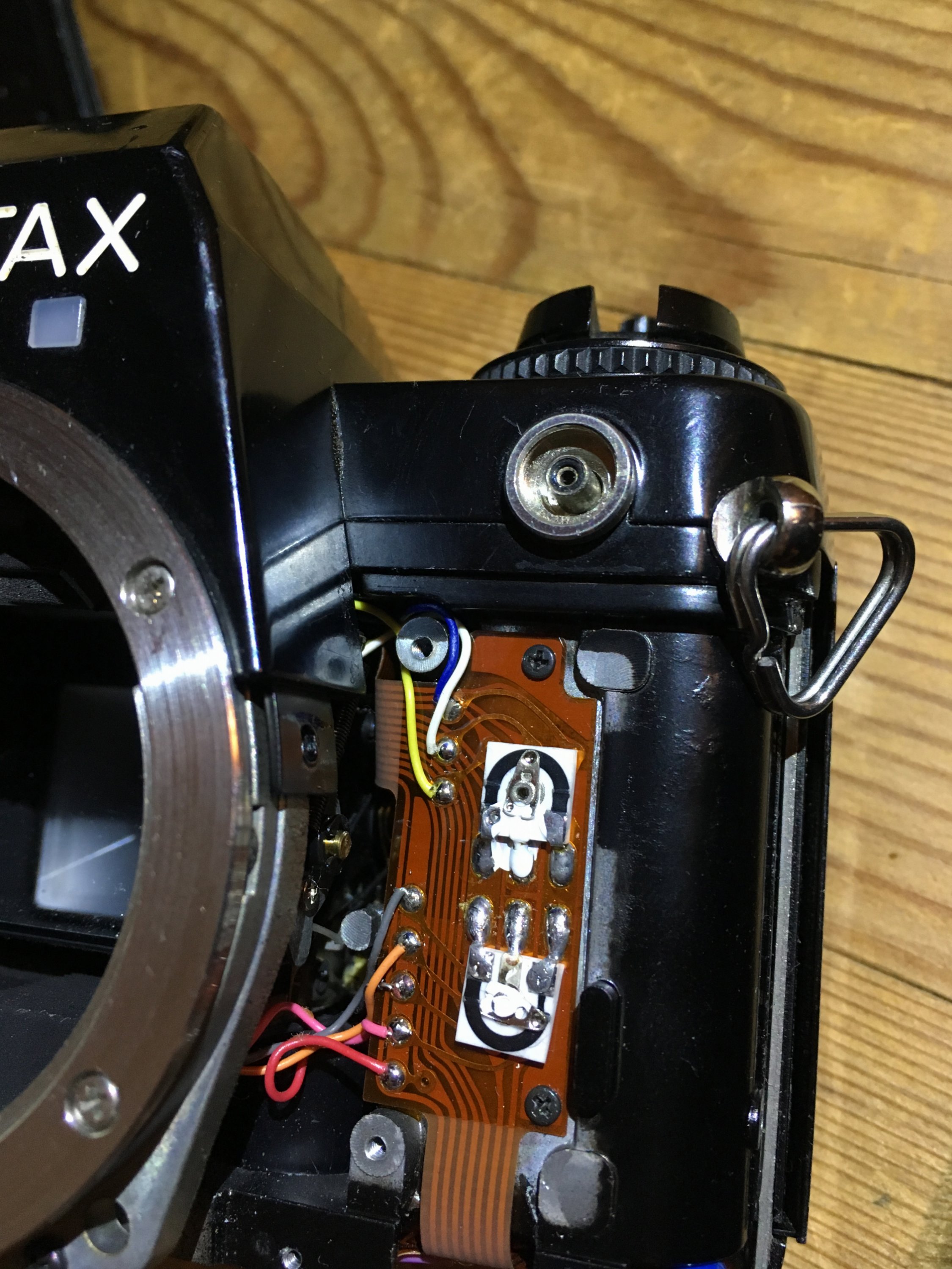

Here are some shots of the some relevant circuitry by the way - I haven't found many sources for this online, so now there's this
I also found that you can access the shutter damper flywheel without removing the top cover - just remove the bottom cover, and the lower part of the mirror box shroud (as seen here). Useful for quieting a squeaky flywheel like mine had when I got it.
