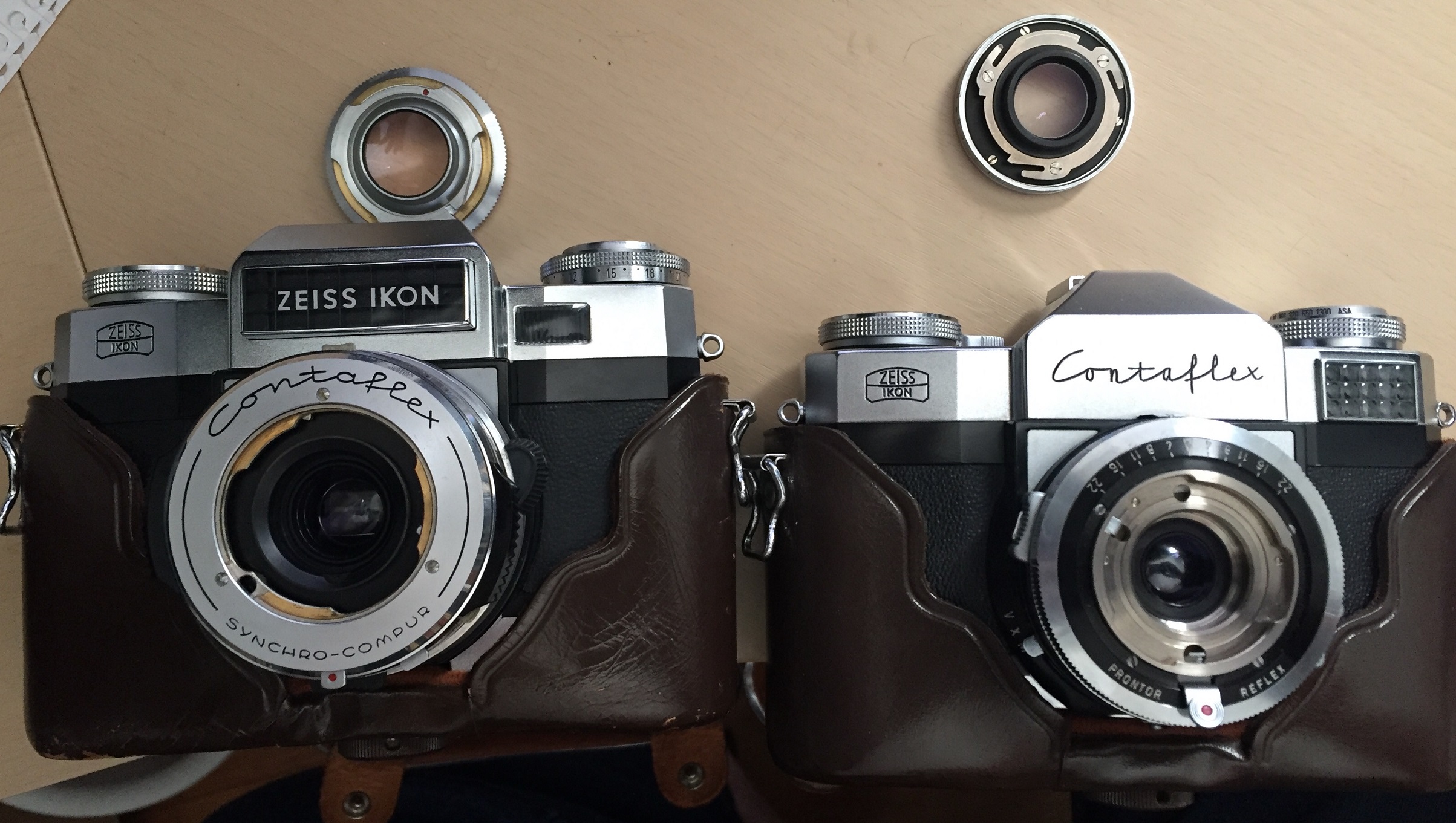

Mine is a Contaflex Super B. Look close at the mount and see if it is the one that is "bad" on the BC.
This is obviously not the same mount on the left and is a Pantar 50mm on a Prima model, but it's the only other Contaflex I have for comparison.
