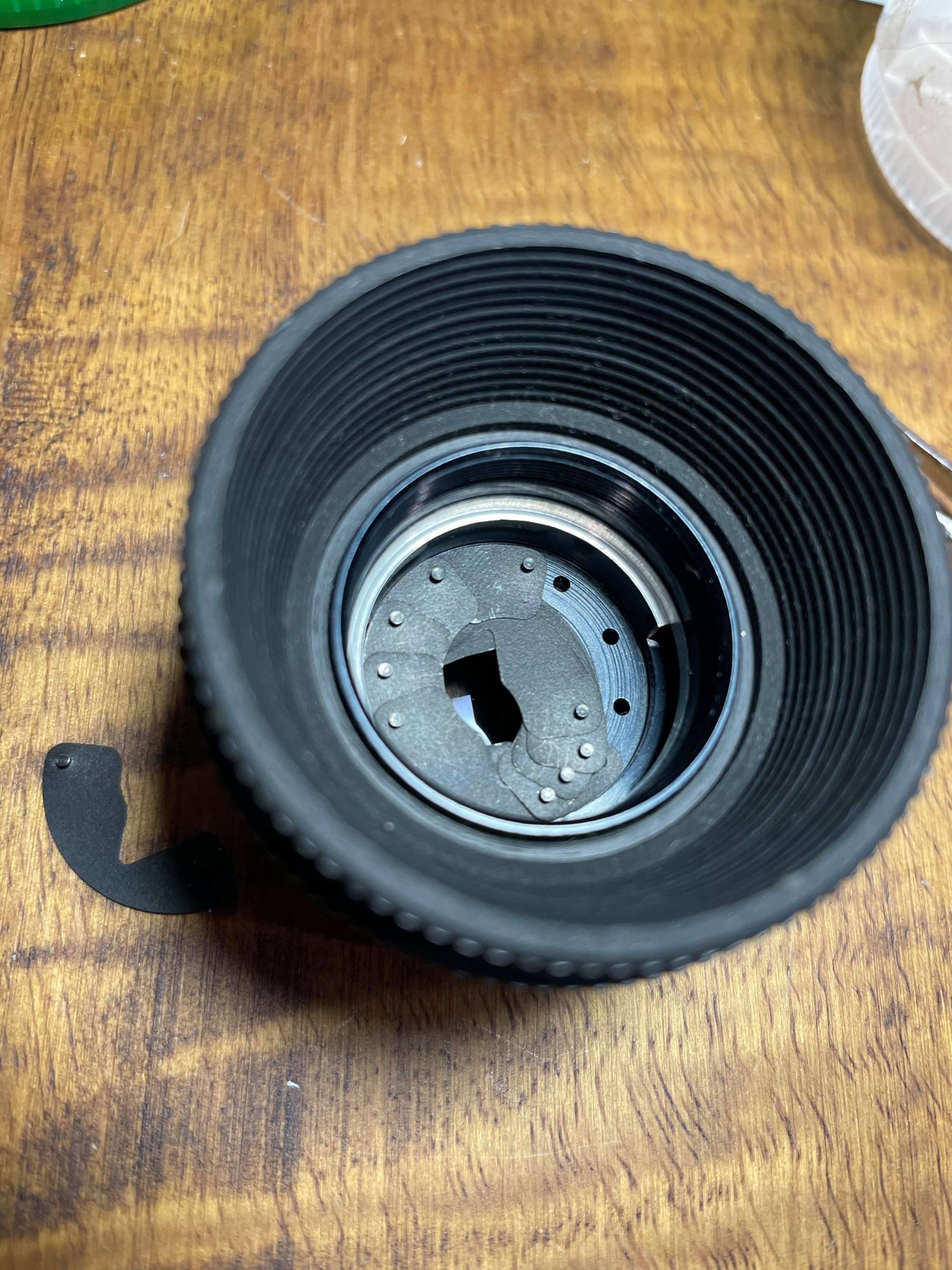

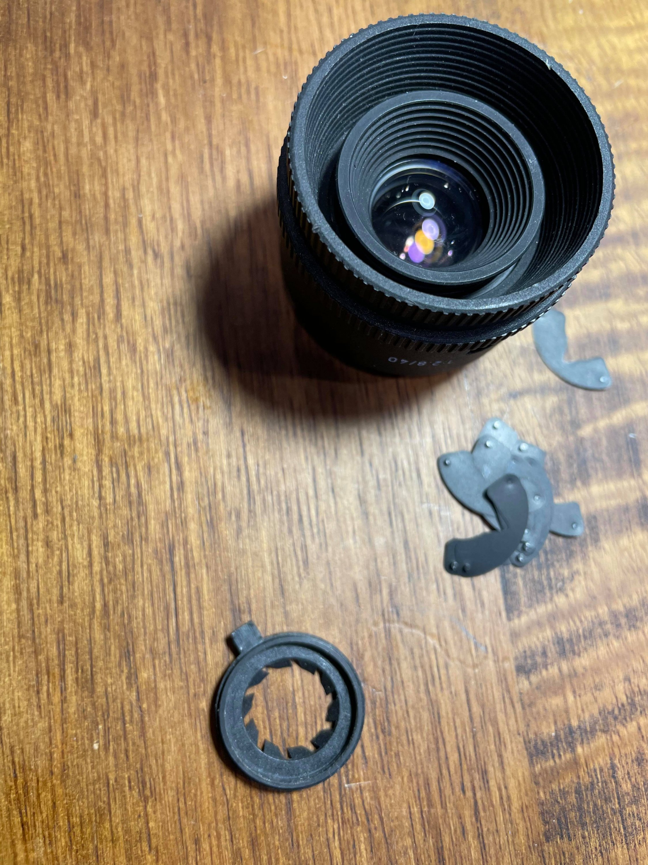

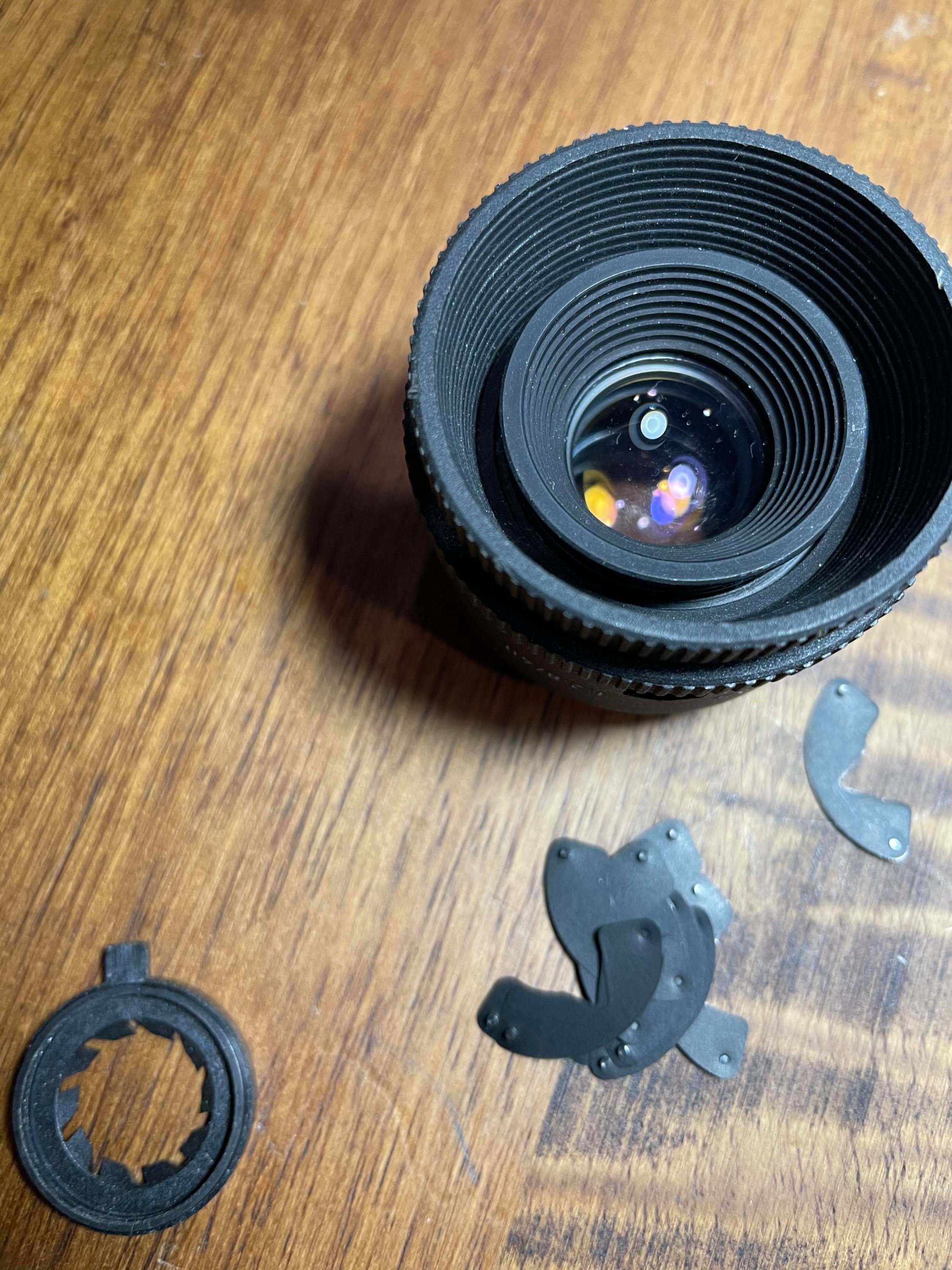

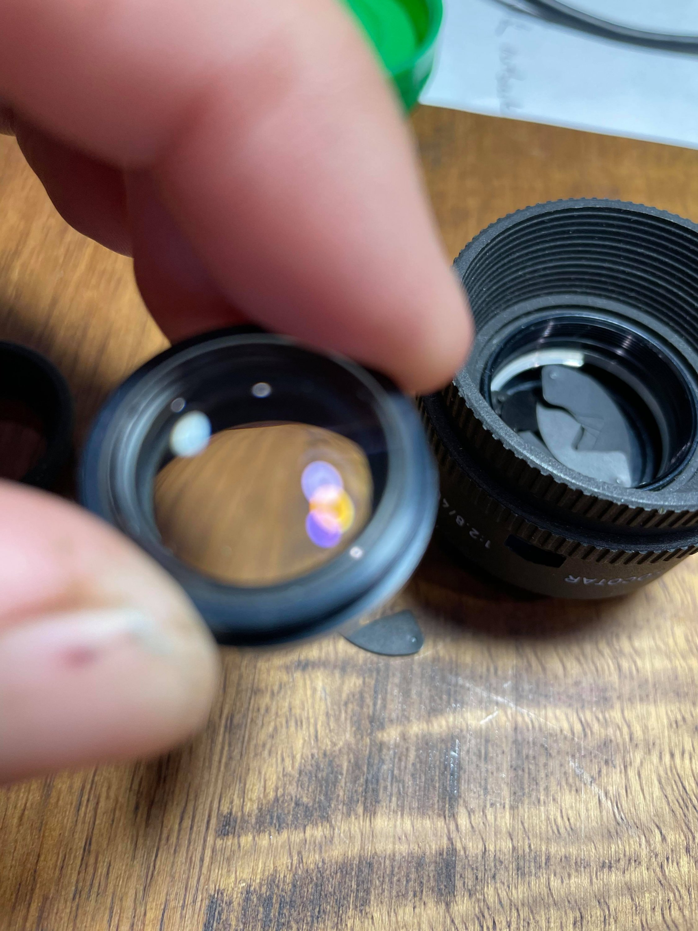

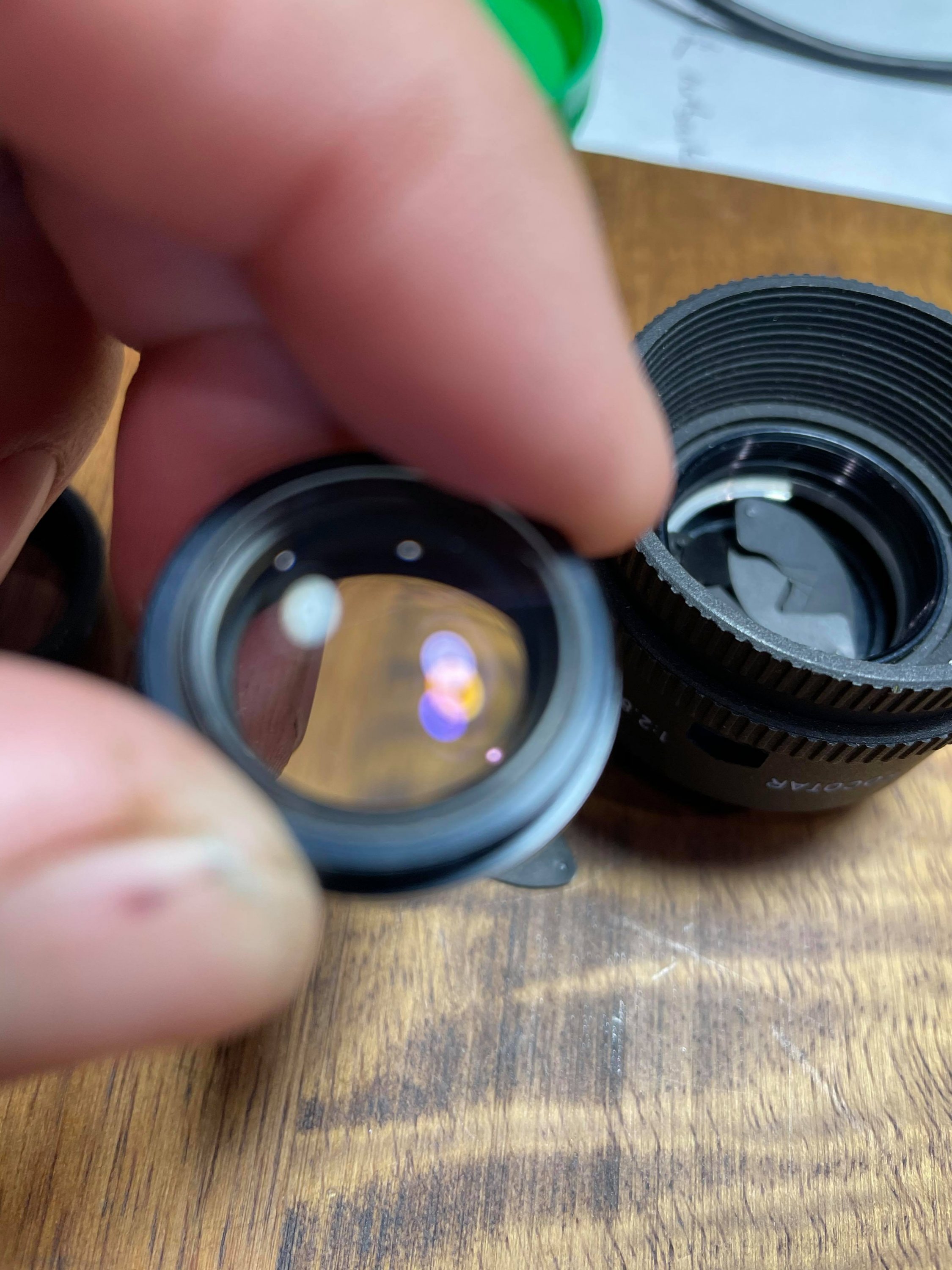

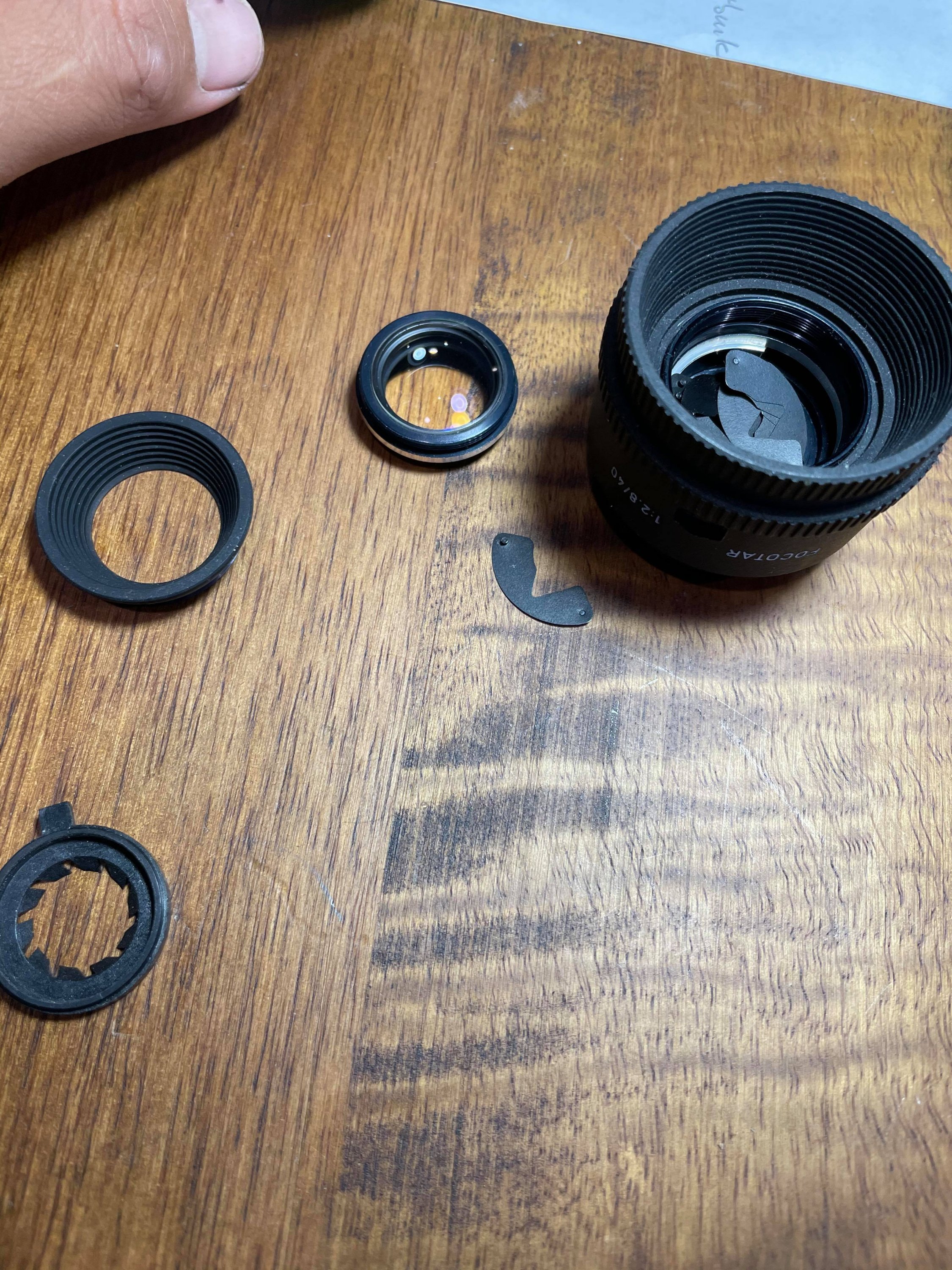

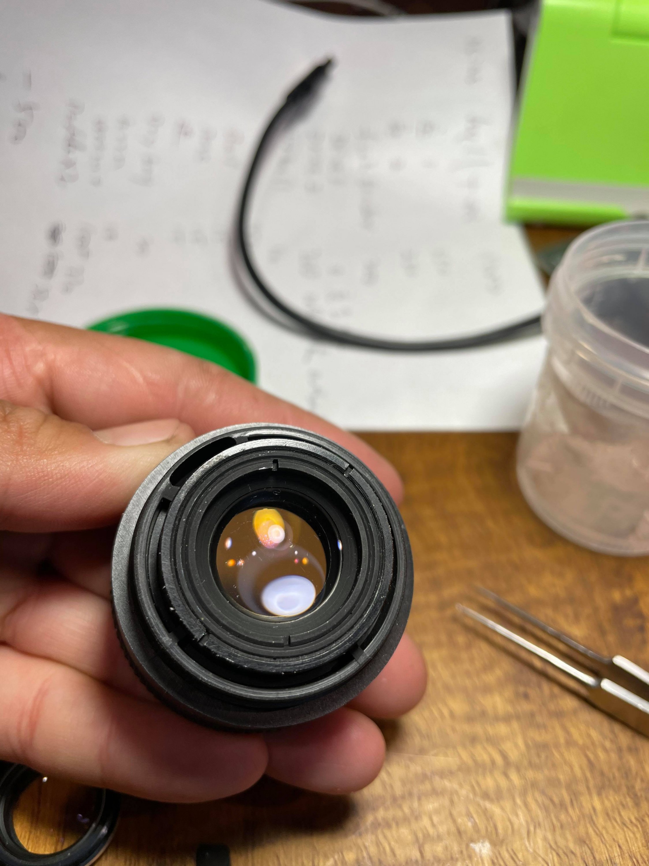

It turns out the owner selling the Fotomat V35 for $200 had taken apart the lens to clean out the dust, but never put it back together! Aperture blades everywhere. Seems dicey to purchase it like this...

Hmmm, I'm not sure what I would do in that situation. If you feel capable, the lens assembly shouldn't be too hard. And if it isn't easy you'd be looking at a small repair bill. Any competent repair shop should be able to assemble the lens for less than the price of replacing one. Replacements seem to be around $300-$500.
The V35 still works with a typical 50mm lens, but without the autofocus. In practice, for me, the AF is great for changing heights and composing, but I still have to do tiny tweaks for fine focus every time. Just saves you the back and forth of raising/focusing/lowering/focusing/rinse/repeat when composing.
Personally $200 is a steal for the enlarger. And if it makes you feel any better I have the Vario-Contrast module and a box of lamps I was testing (some successfully) before my Heiland arrived. You're welcome to pick them up from me in WeHo for free if you need it.

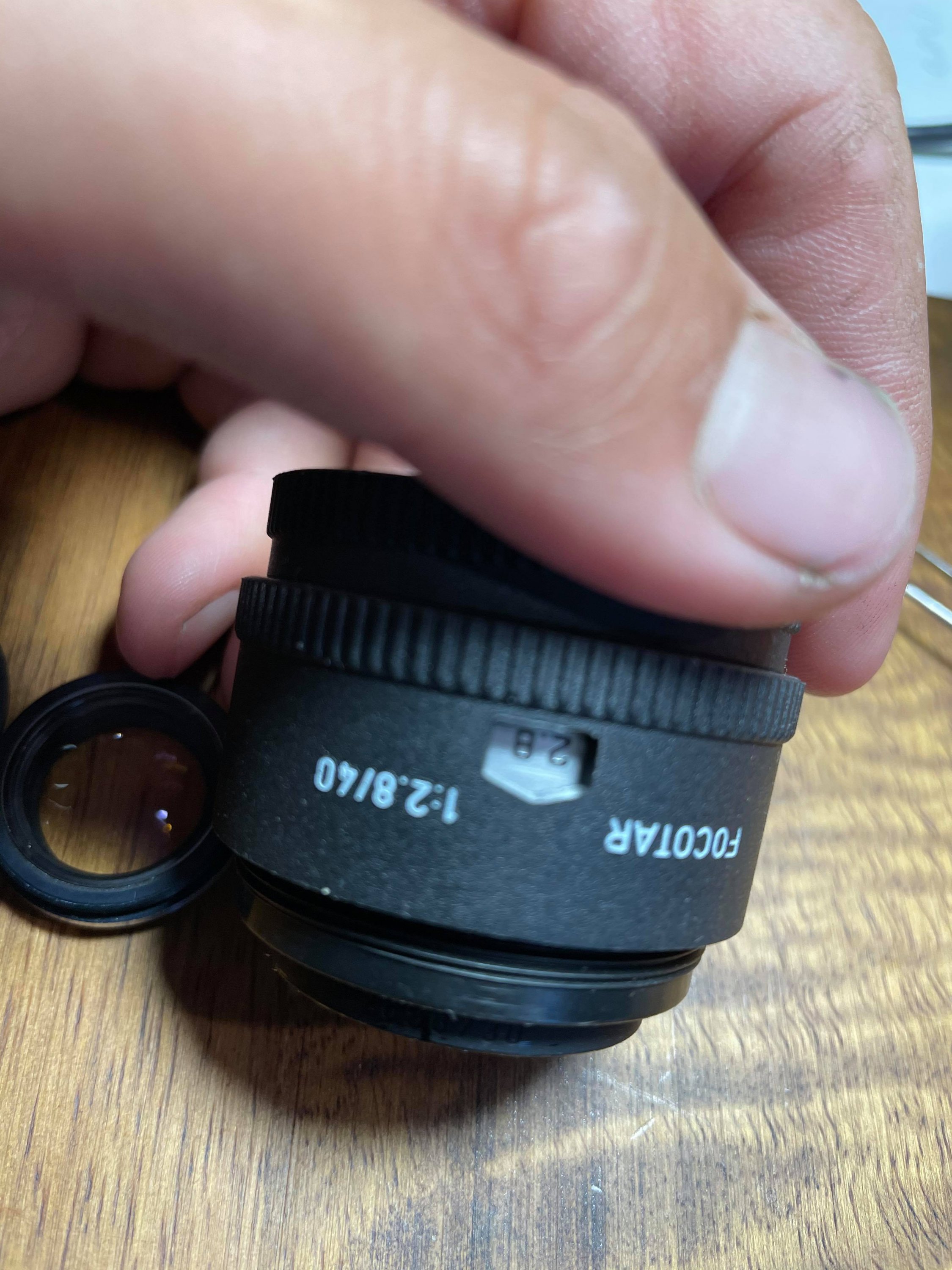

$200 is still worth it, in my opinion. If you can't put the lens back together, they do come up from time to time on eBay. i actually replaced mine with the 40mm Rodagon.. and sold the original for $100 on eBay some time back. Any 40 or 50mm lens would work in a pinch...

Radical. I called a camera repair shop recommended by Samy's but they said they would stay away from reassembling, as they didn't disassemble themselves. Good to know these 40mm are available from time to time. What's the exact model of the lens, if I need to replace?
