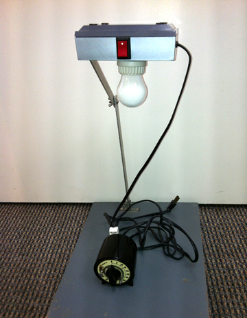

I made this gadget to make duplicate dental x-rays about 40 years ago and it still works fine. It could be used for contact printing as well. All you need are a couple of items from a hardware store and Radio Shack plus a piece of plywood. The timer could be optional. The whole thing should cost very little and is easy to store.
